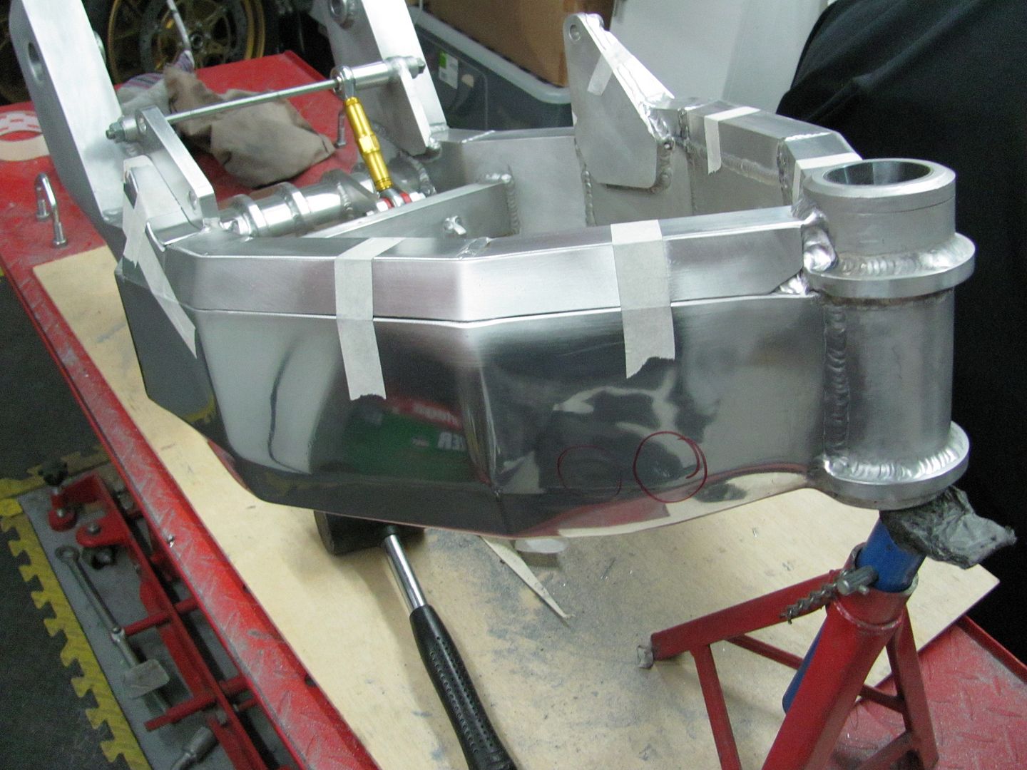

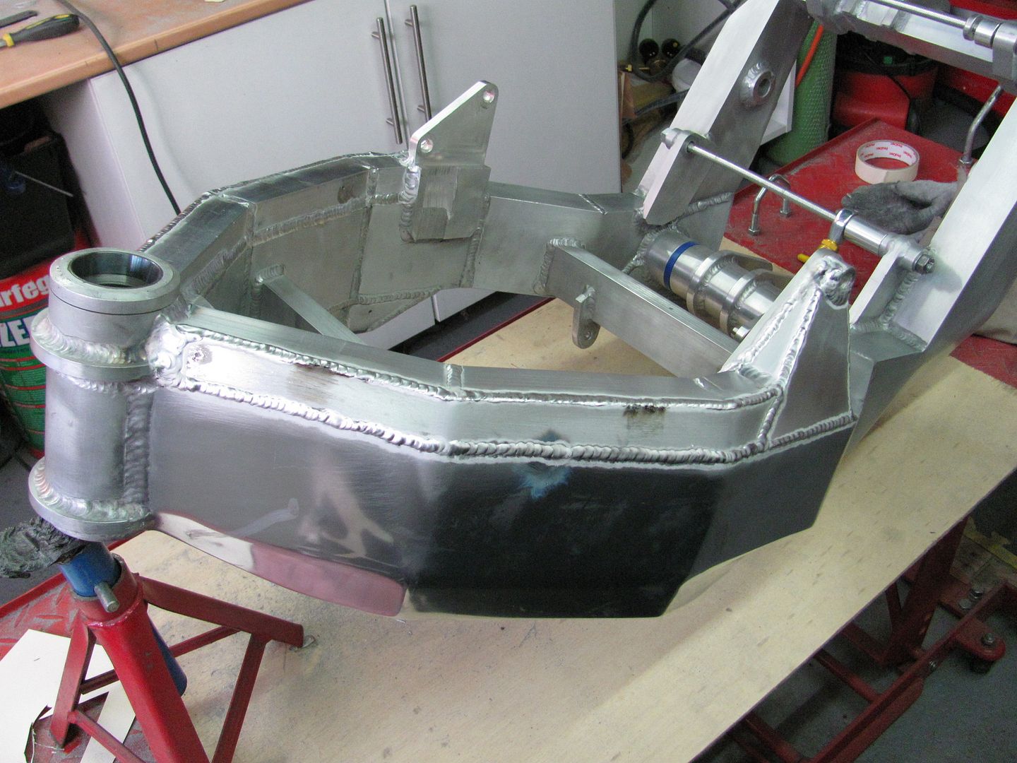

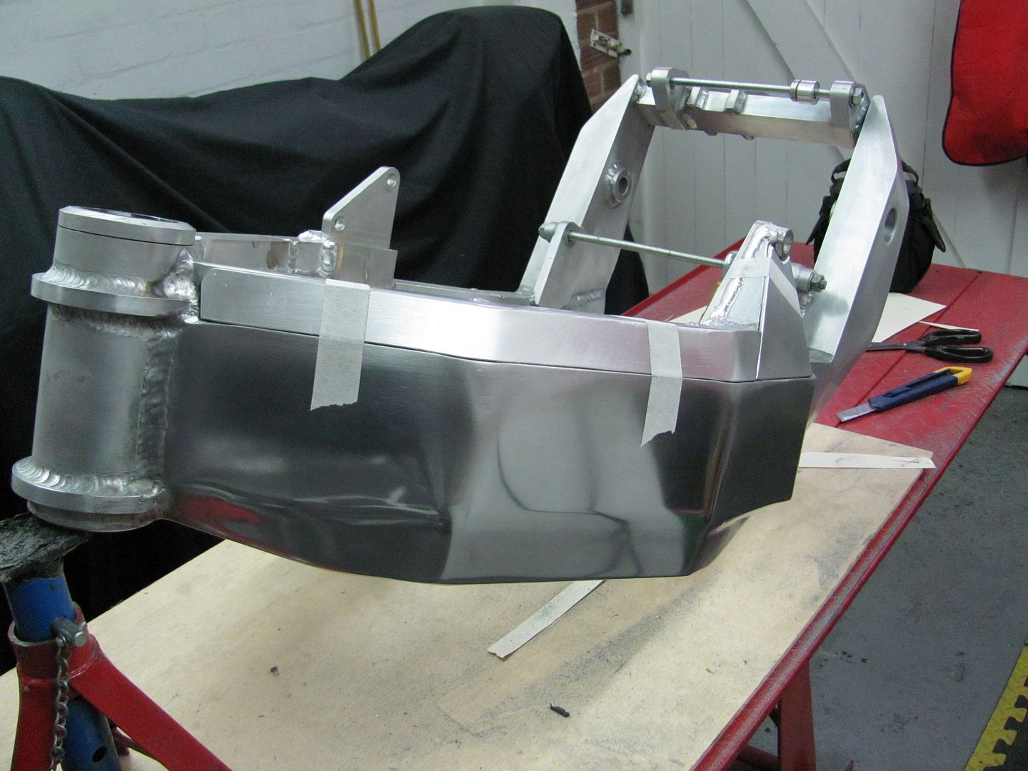

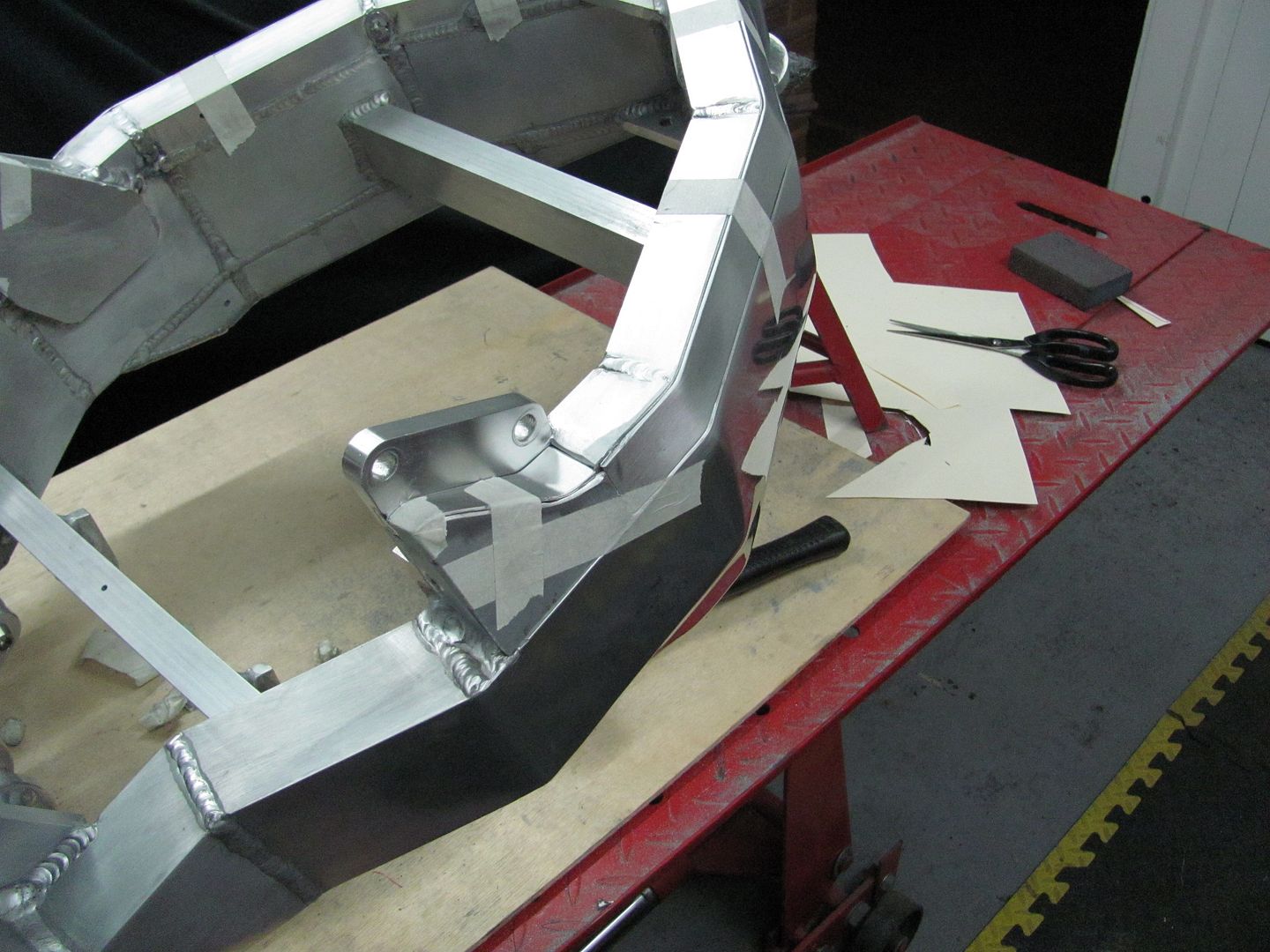

Ok got all the lower section parts welded on
And made the covers for one side, will finish other side tomorrow and get it all welded up Monday
Roast beef :fuck2:

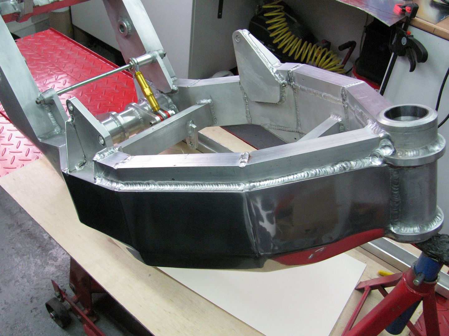

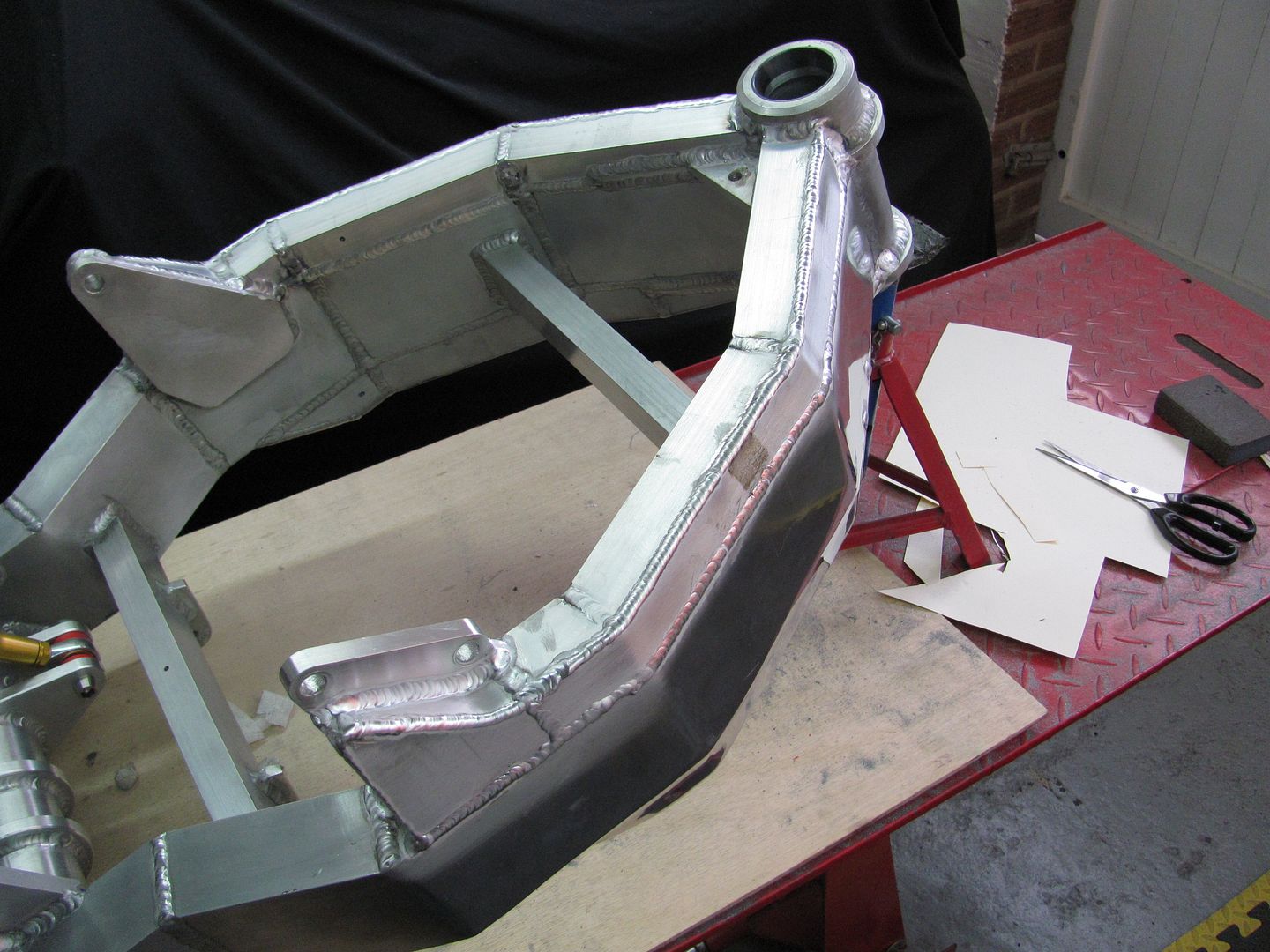

Little update:
Got the parts made to box up the other lower side, will get both the lower section sides welded tomorrow and smoothed over.
Roast Beef :miam:

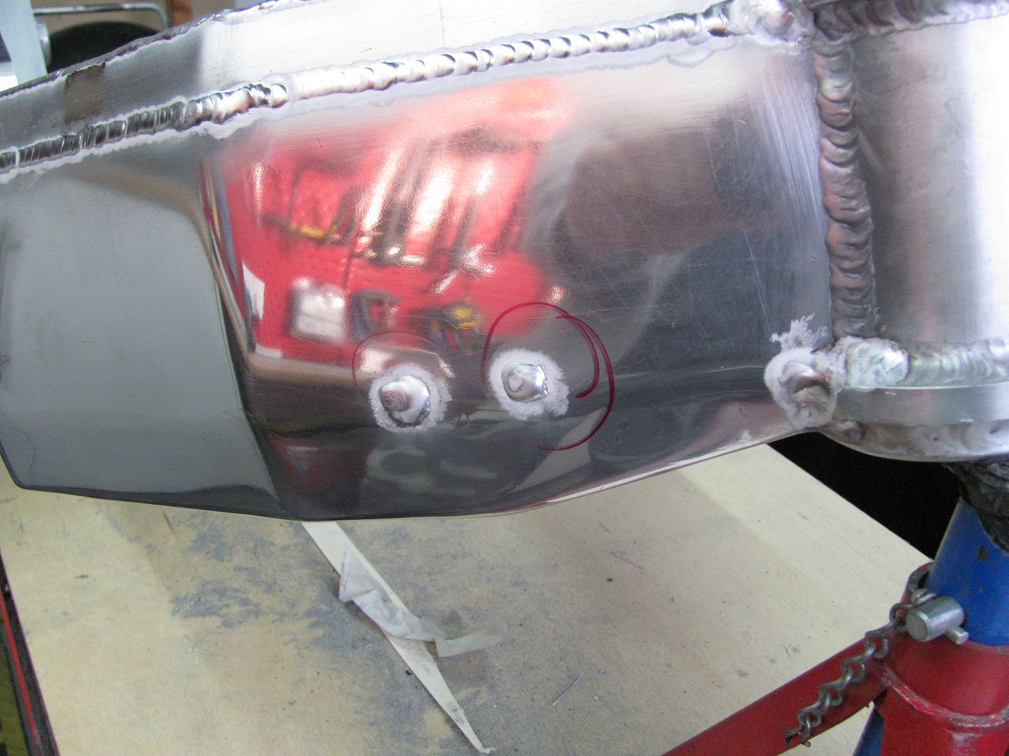

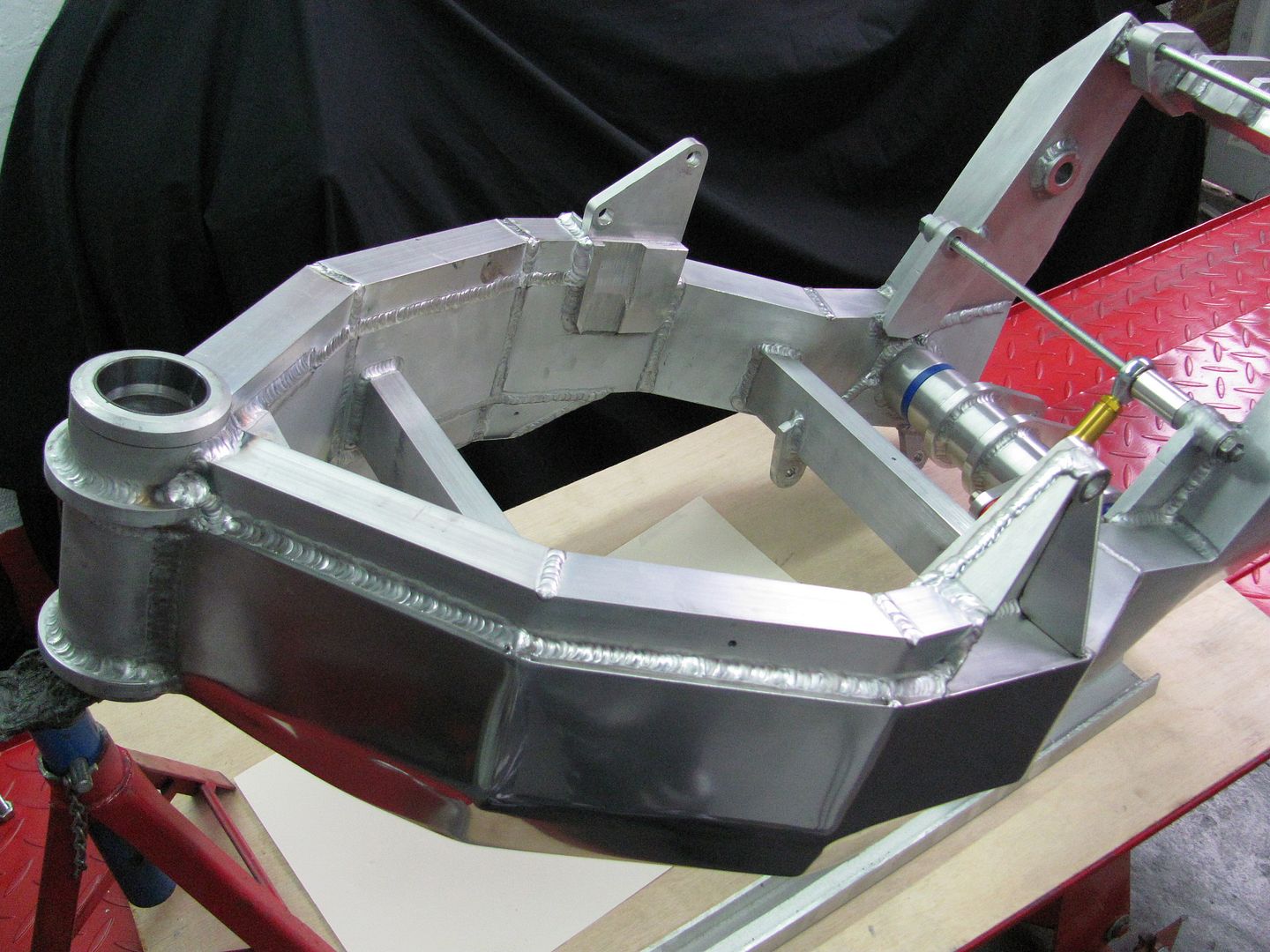

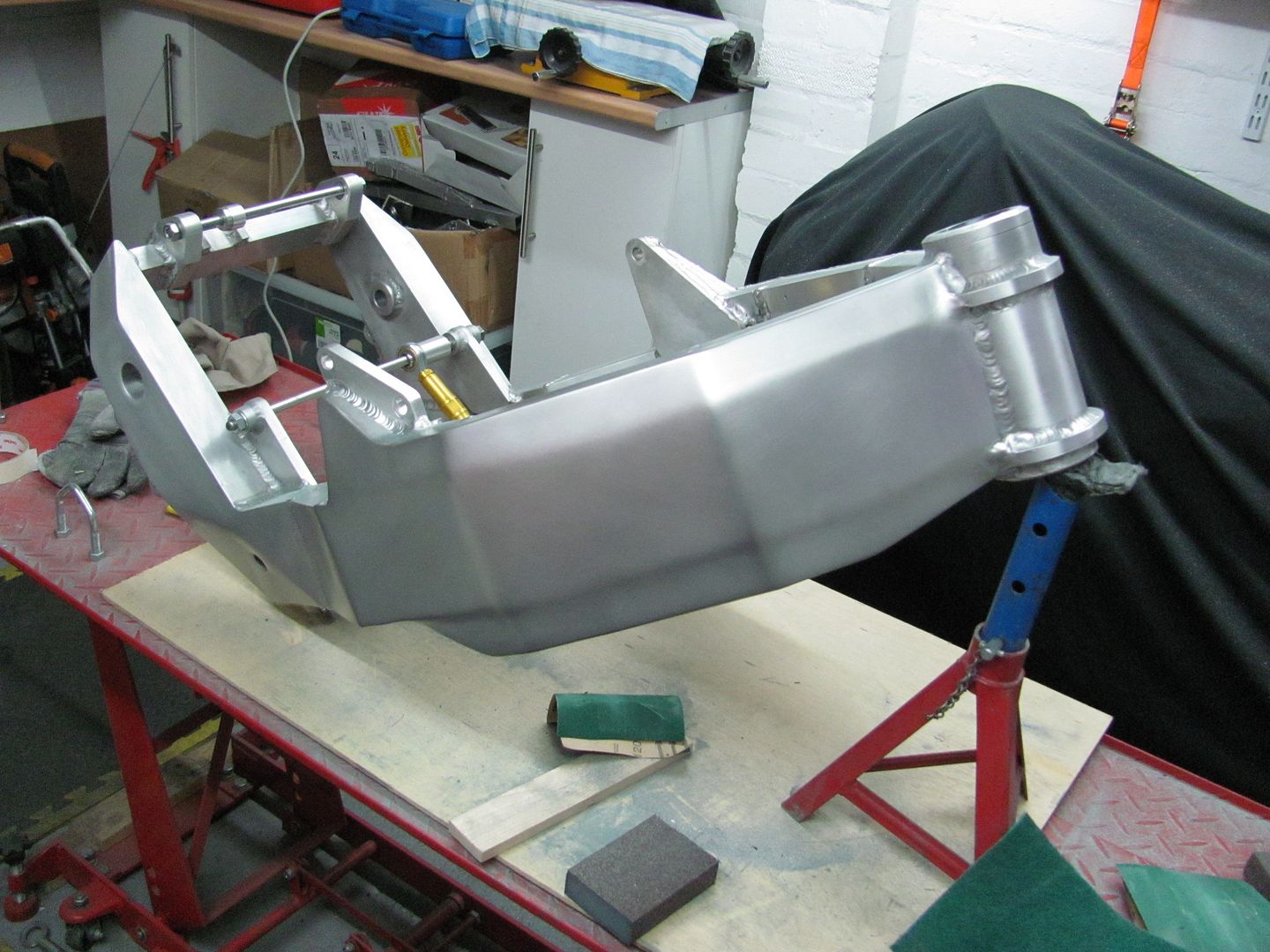

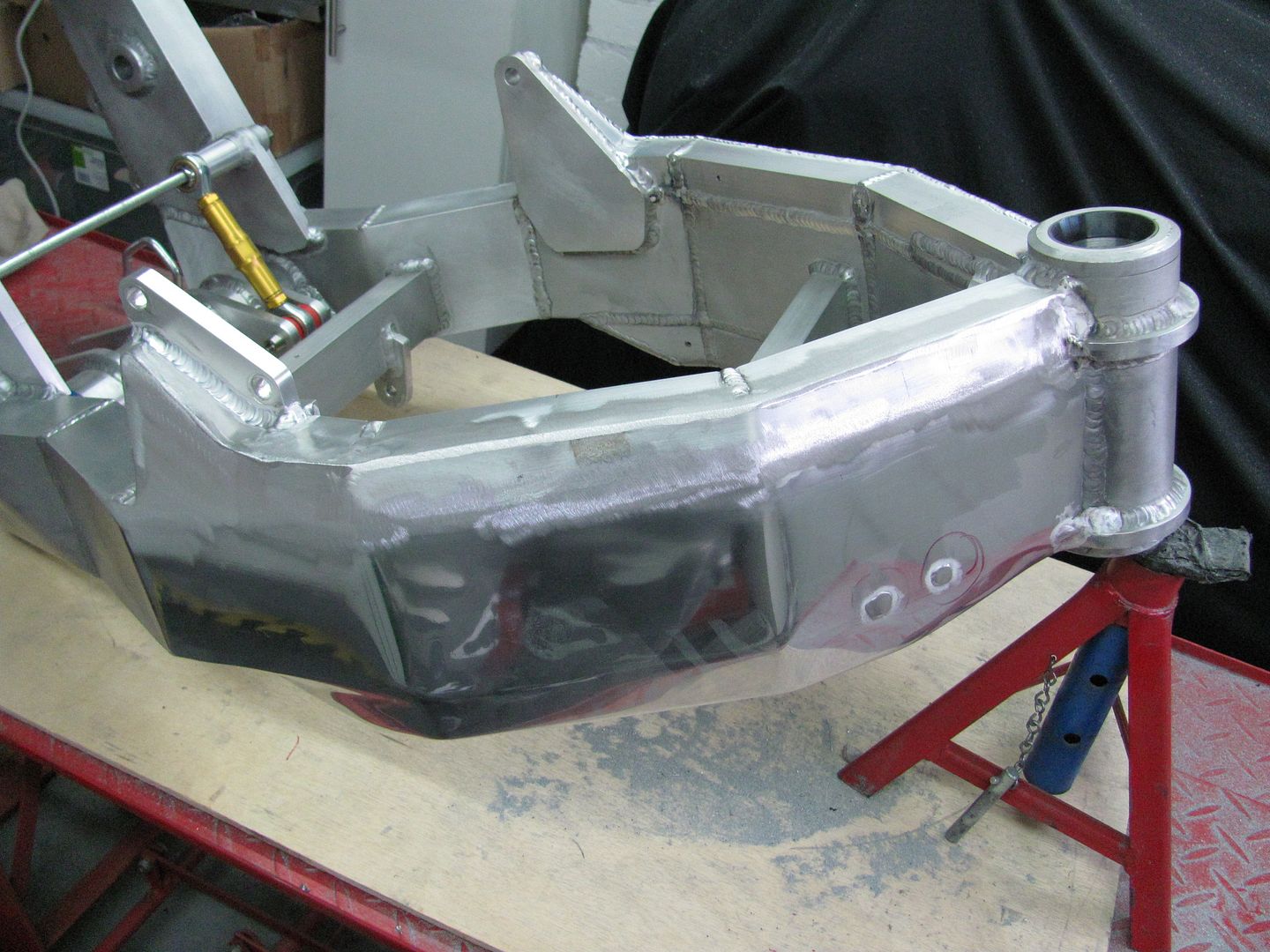

Good progress today :)
Got the low spots filled
All the welding done
Started with angle grinder
Then finished by hand

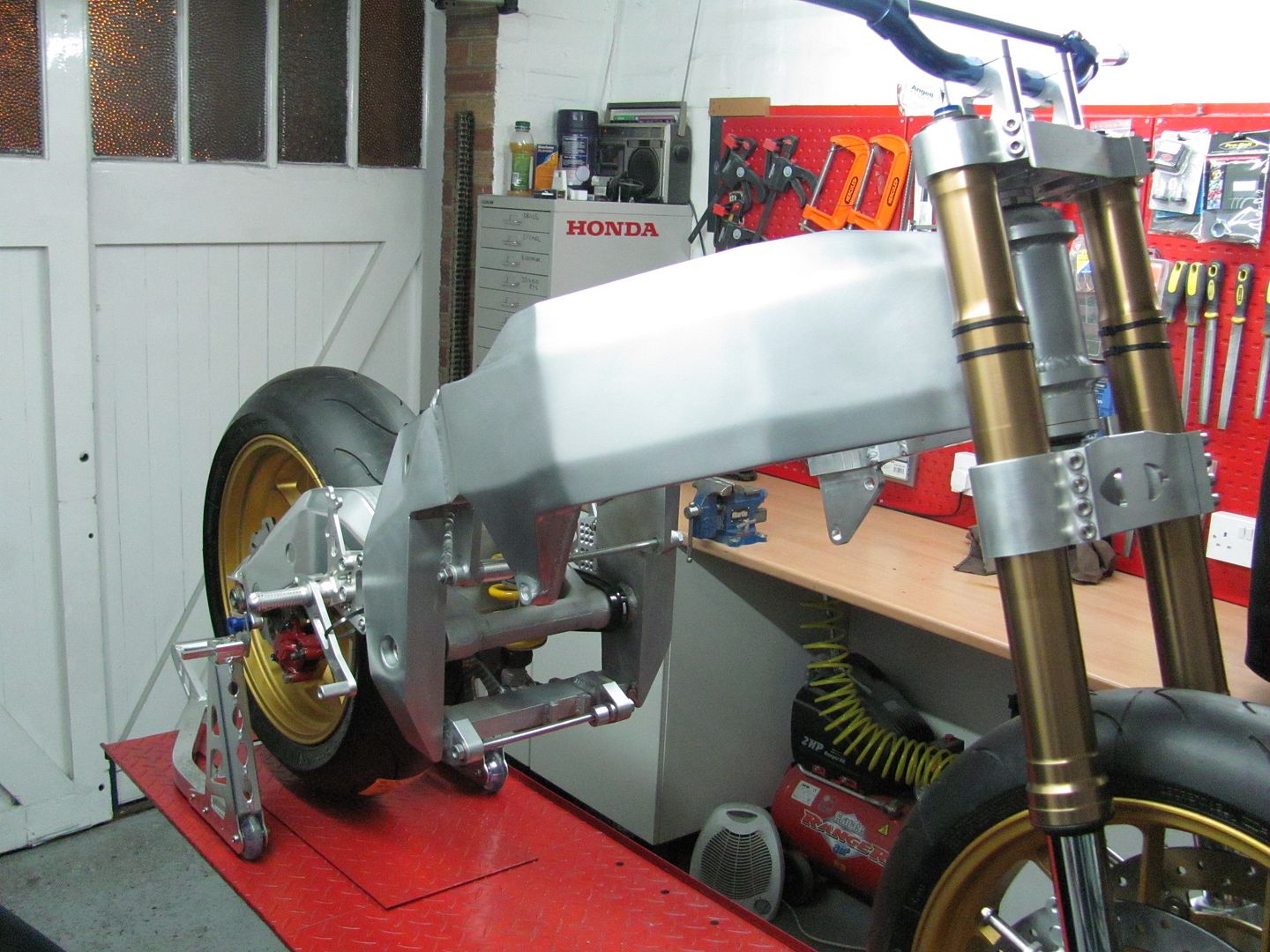

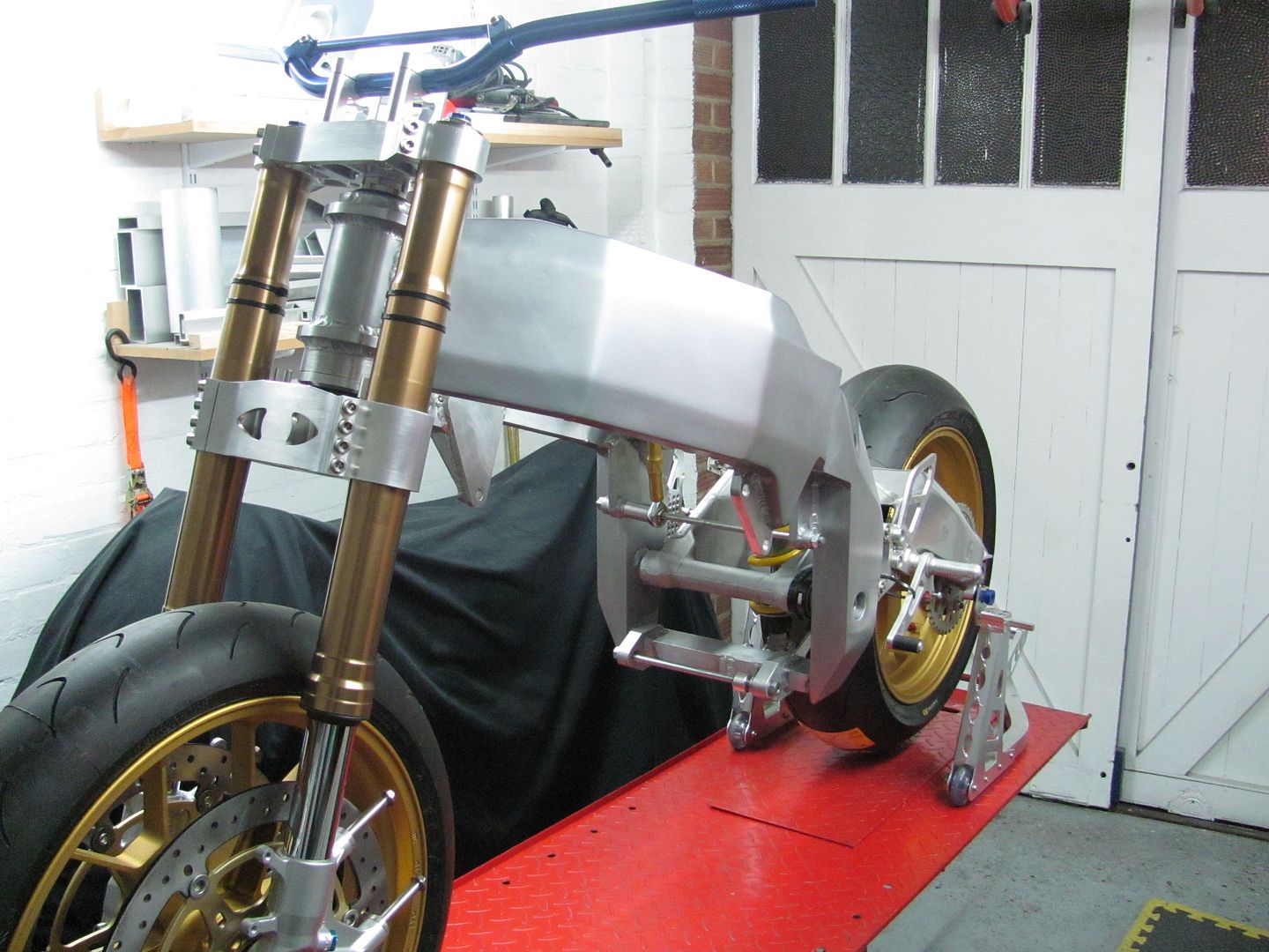

Both sides rubbed down to a perfect finish ready for polish later, bike back on it's wheels to check wheel alignment etc, all spot on, nice.
ROAST BEEF POWER!
