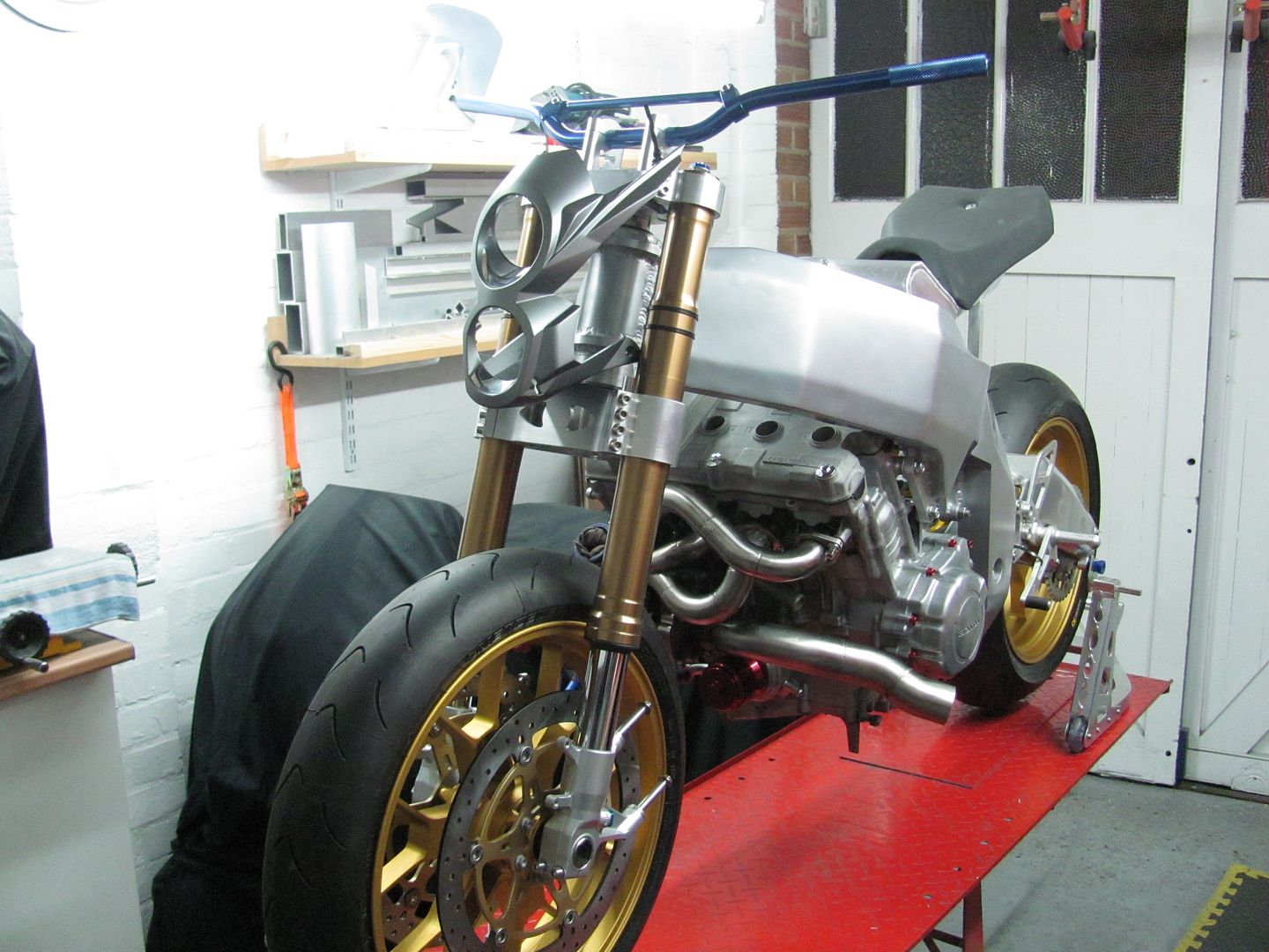

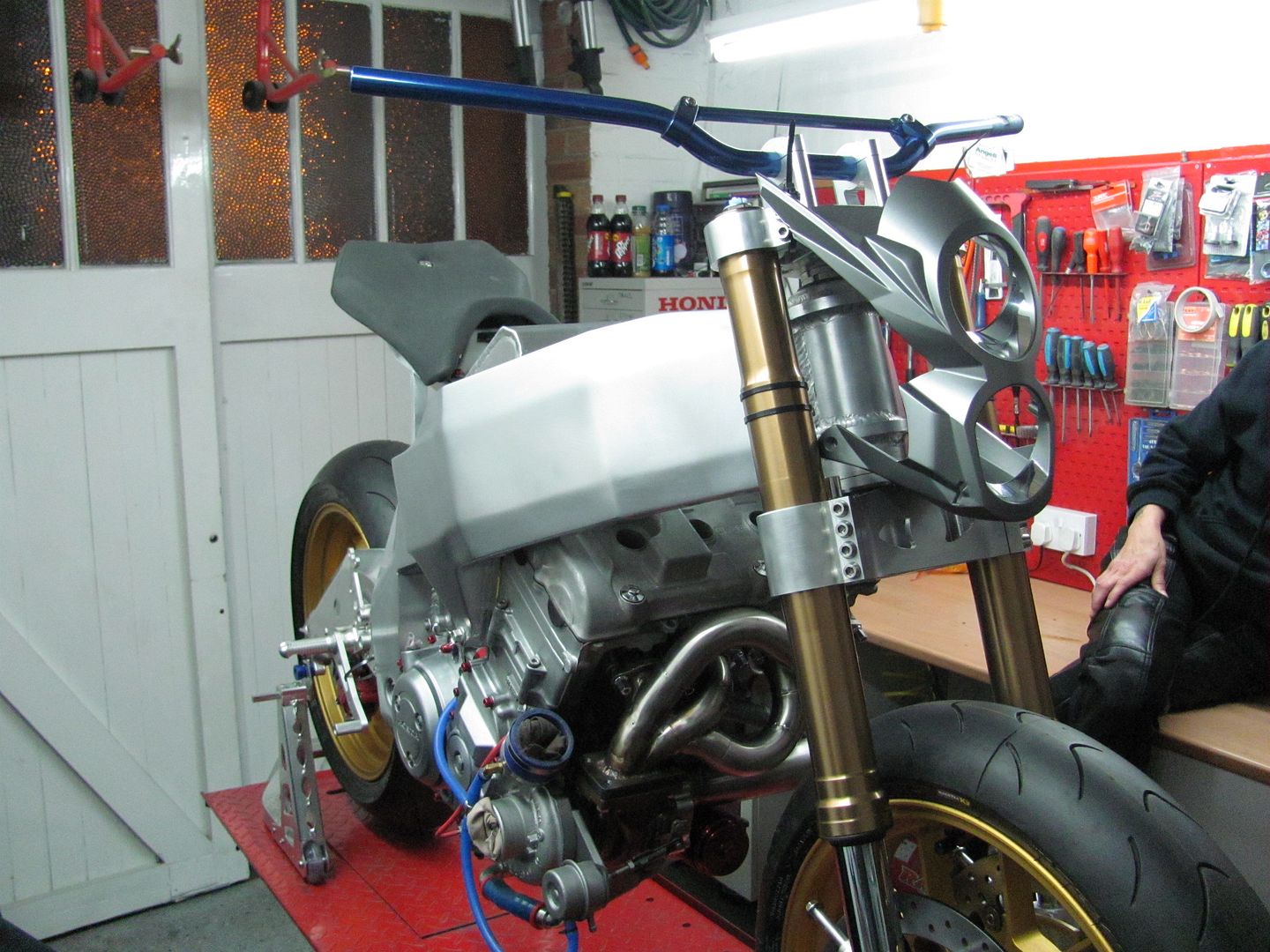

Ok, got the motor fitted and checked out the headlight of choice for looks.

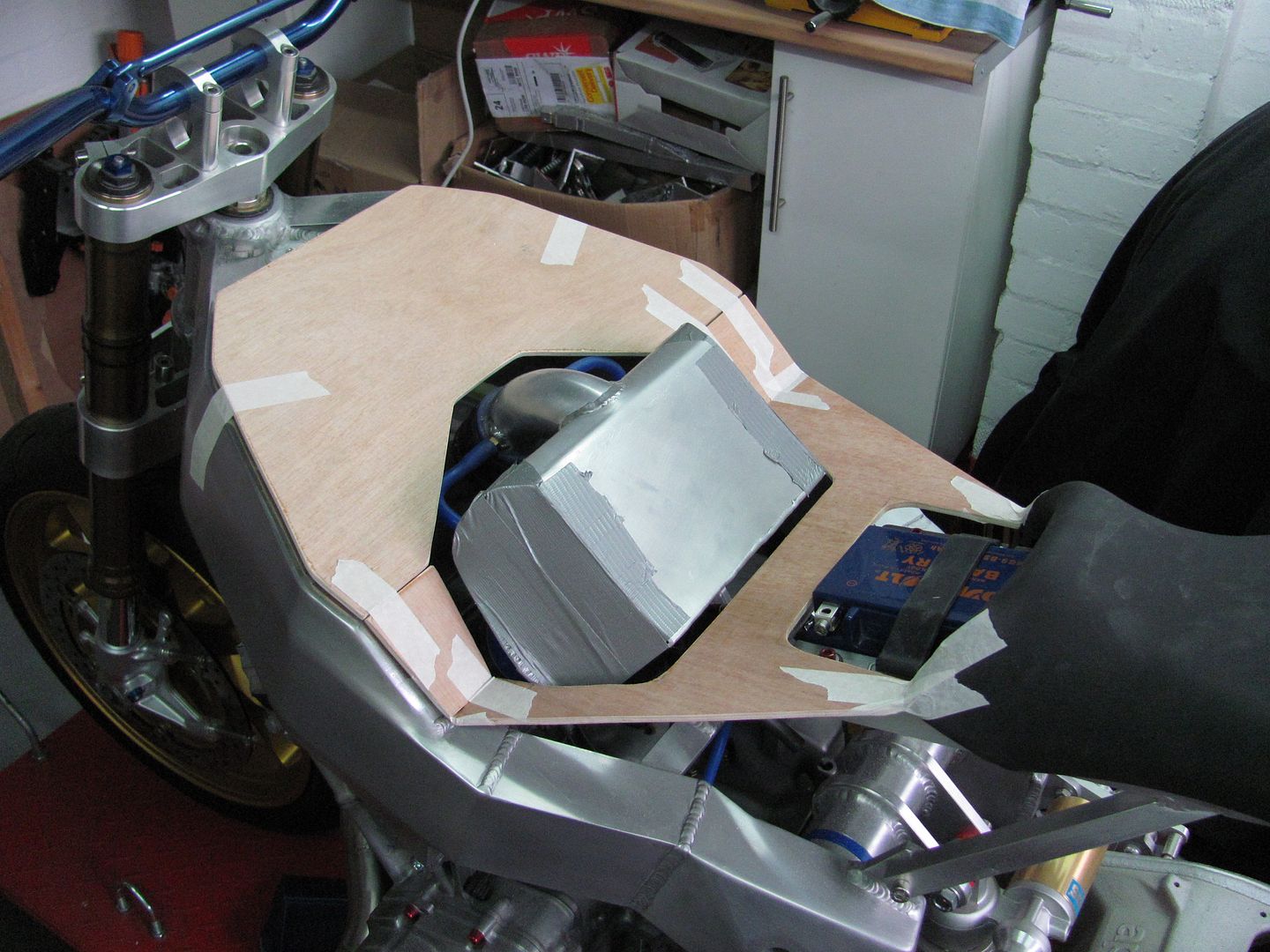

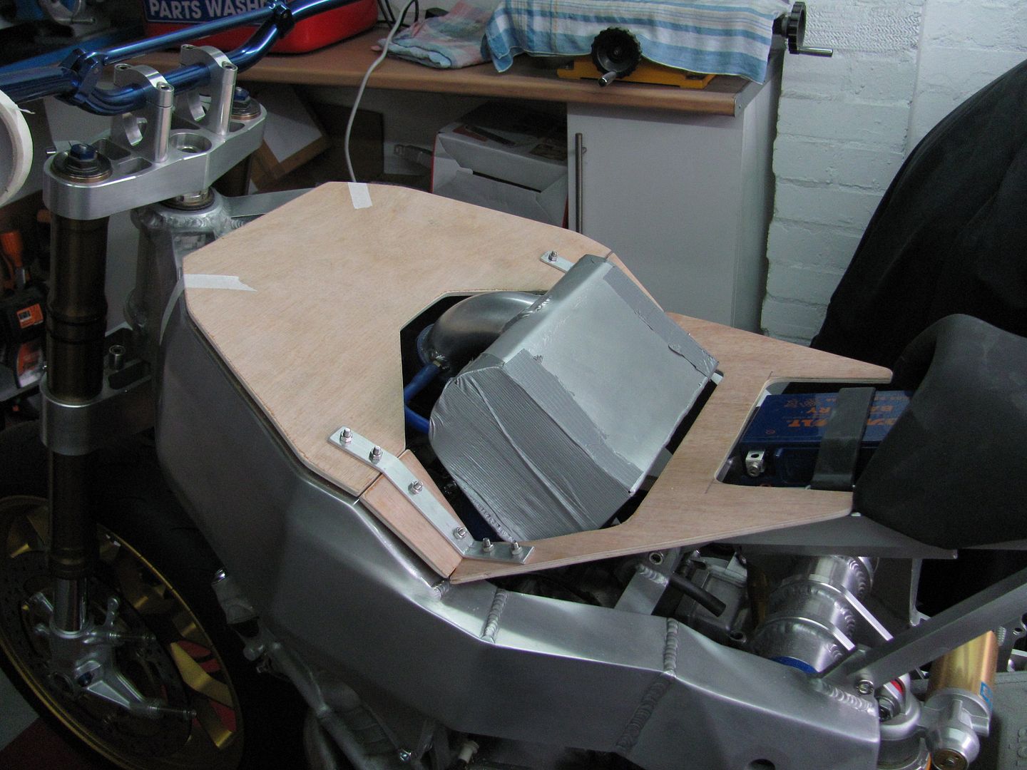

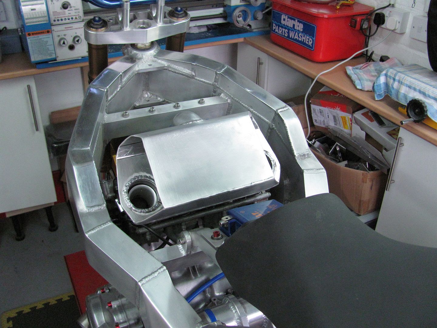

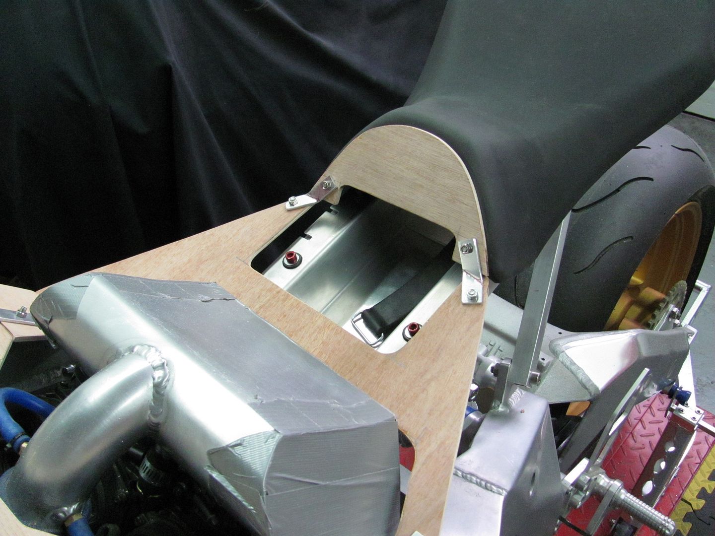

Started the tank fabrication.
Modded the plenum, angled the sides in a bit, will plate it back up later.
Cut the tank base sections
Made up some brackets to hold it together
Fitted the back plate
Will try finish the complete tank mock up tomorrow :)
