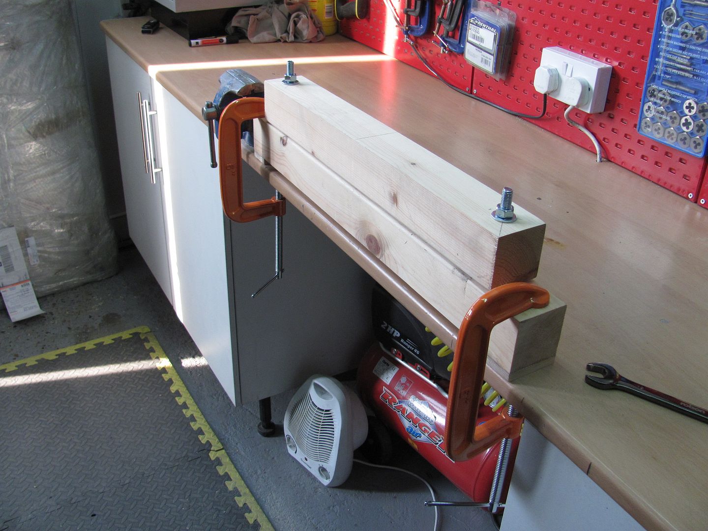

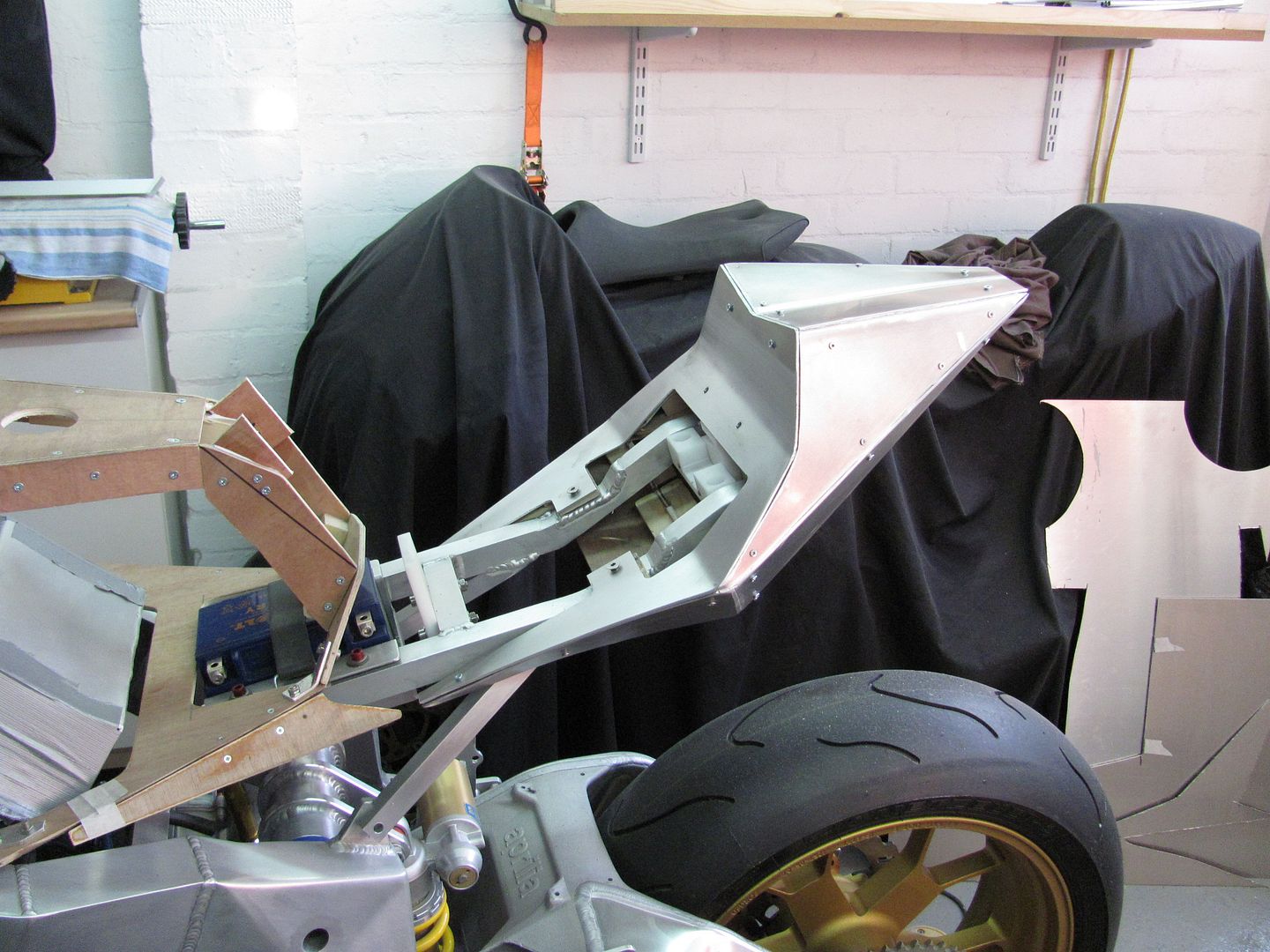

Little update

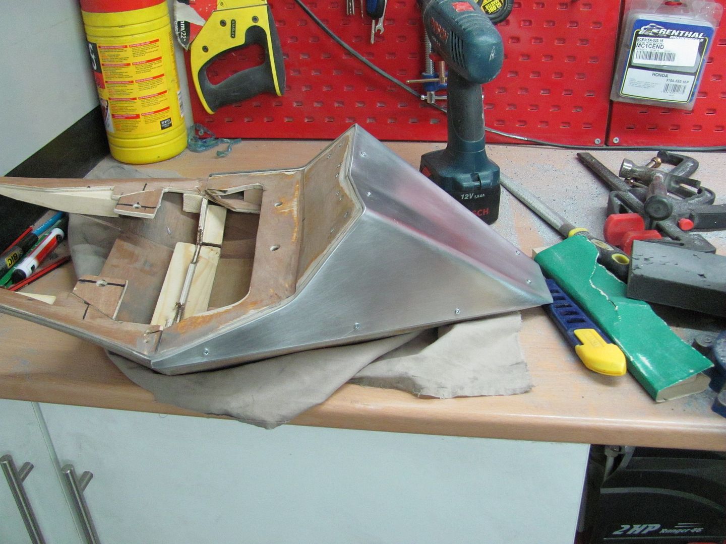

Started covering the tail, my home made sheet alloy folder :)

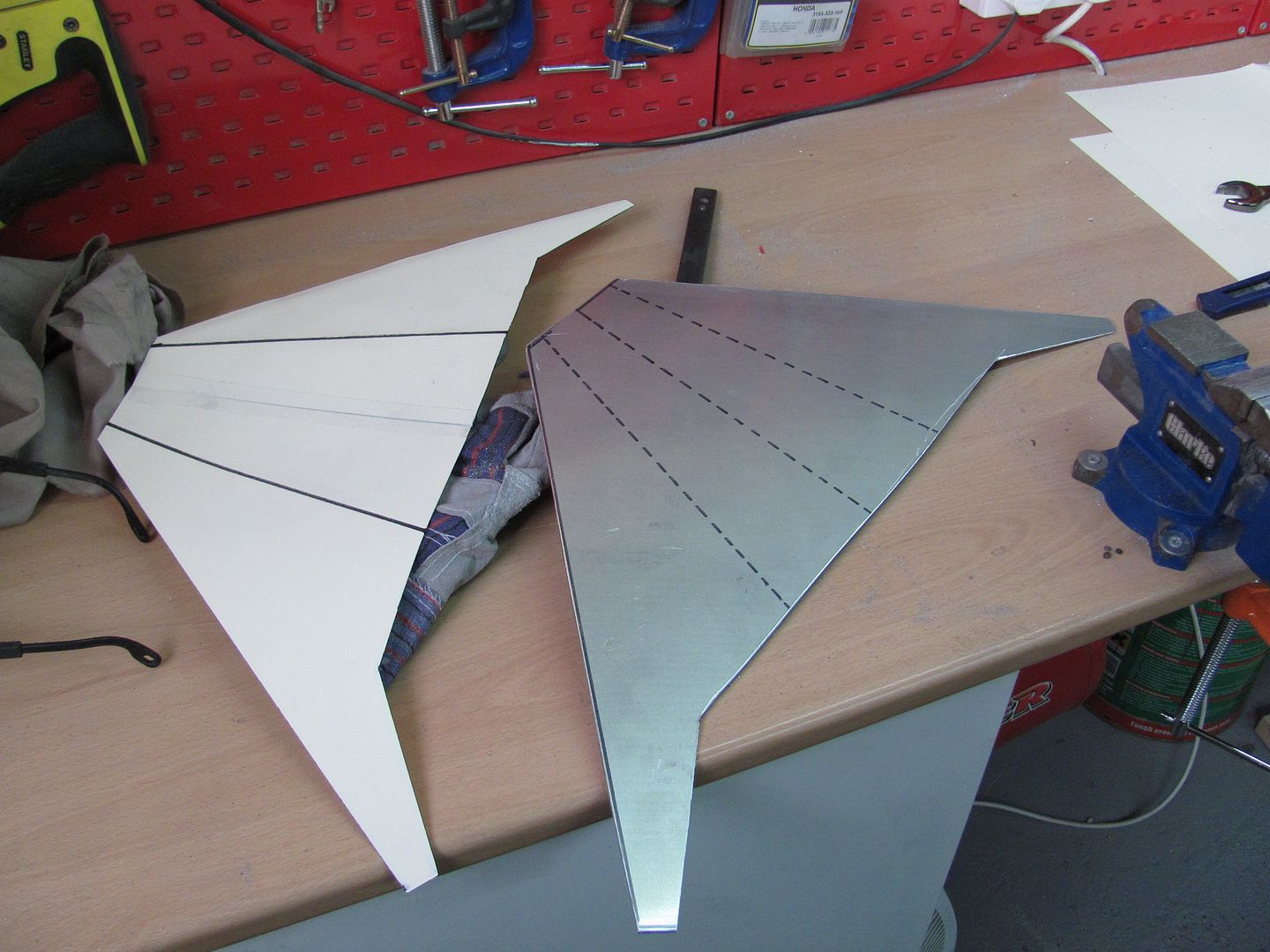

Paper template and cut section
Section folded, fitted and help in place with screws (the screws holes will be filled with weld and rubbed down) sections trimmed with good angles for welding
tried to get a silhouette outline but it didn't work :D

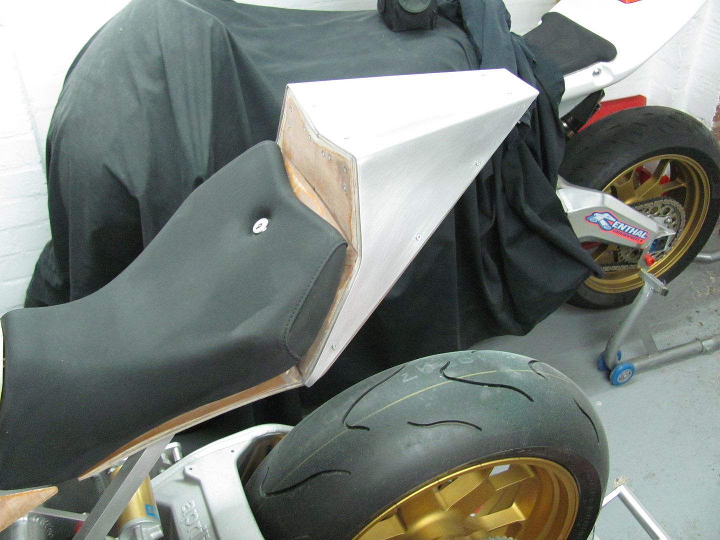

So you keep the wood inside the metal sheet? :confused:
MessagePublié: 23 Mars 2012, 23:25
Messages: 135
:bounce: no, i make the bottom section and get them welded together, make the front section, remove the wood pattern then weld the front on.

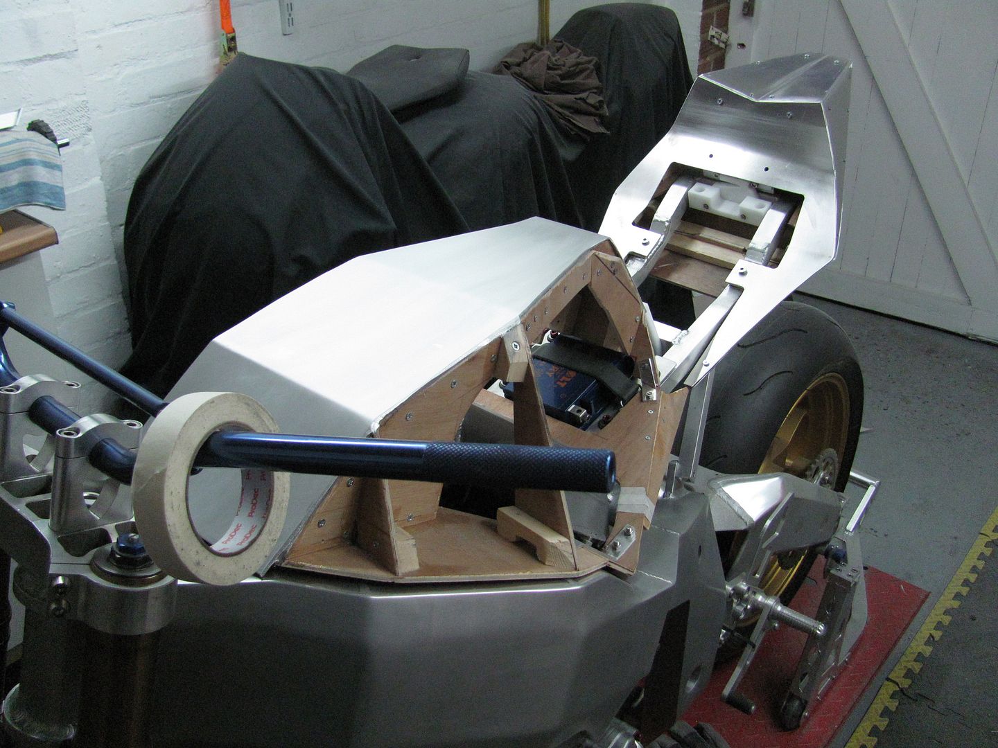

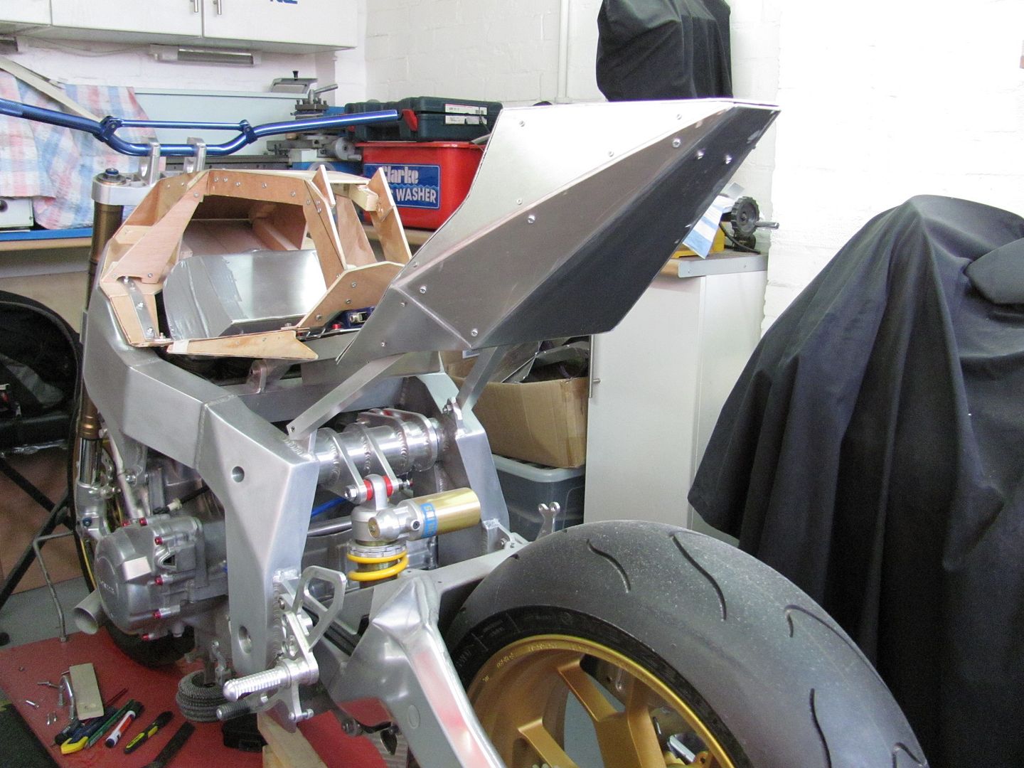

Not much done this weekend due to riding all day Saturday and shagging most of Sunday morning.

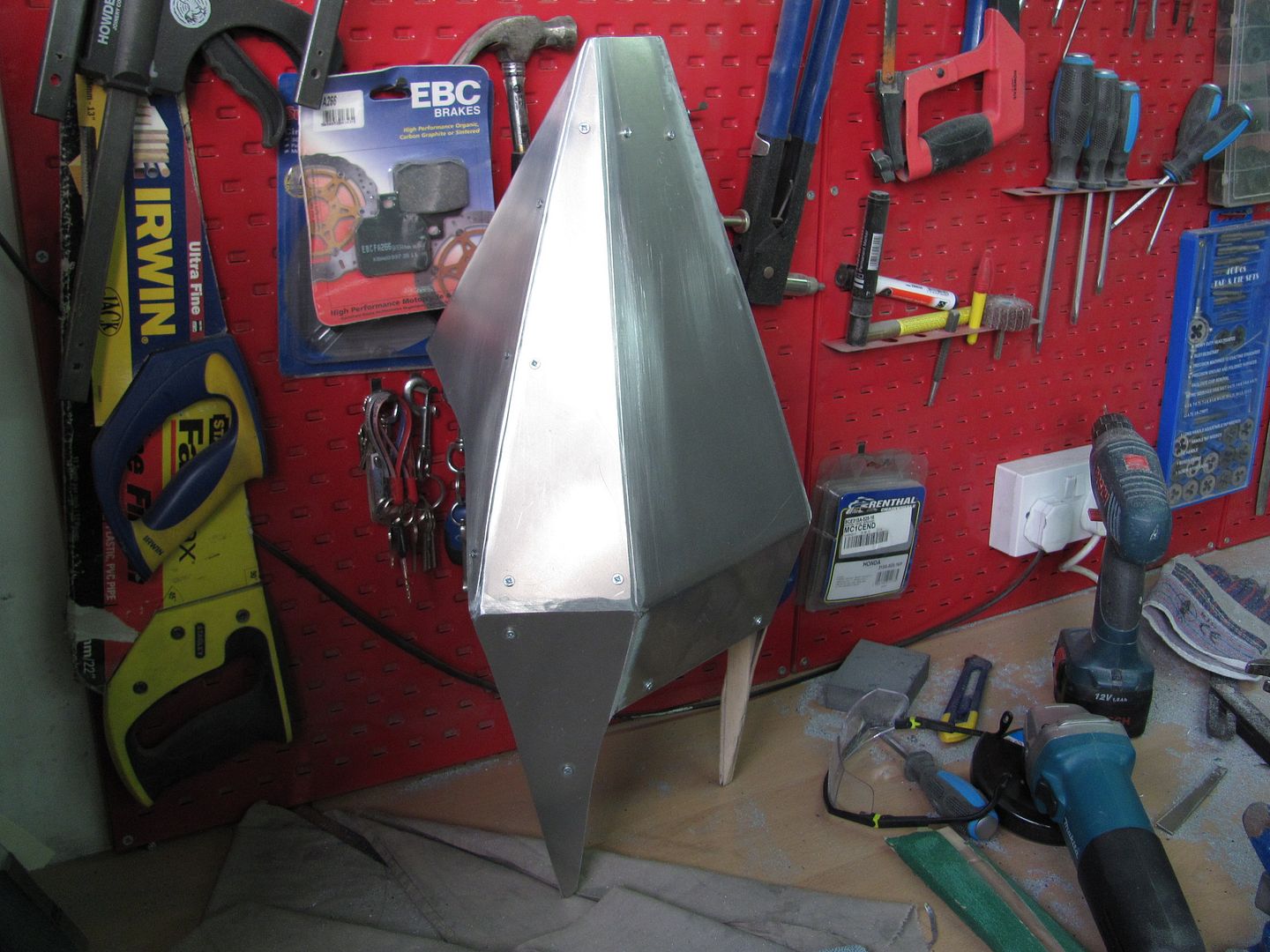

Got the bottom alloy sheet sections cut and fitted, I did intend to fold all the sections but folding gave a rounded corner and I want a Sharp corner so all sections will need cutting, I also have to re make the top.

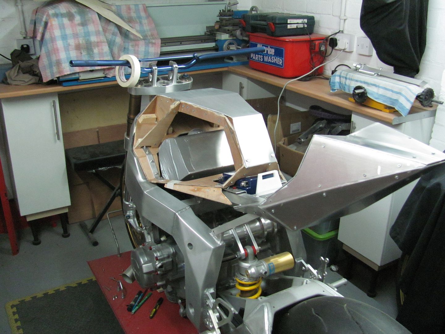

Replaced the folded top section with seperate bits to get sharp corners and finished covering the tail ready for welding tomorrow
Made a start on the tank
