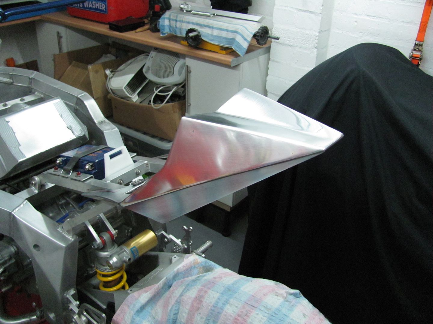

Little update.

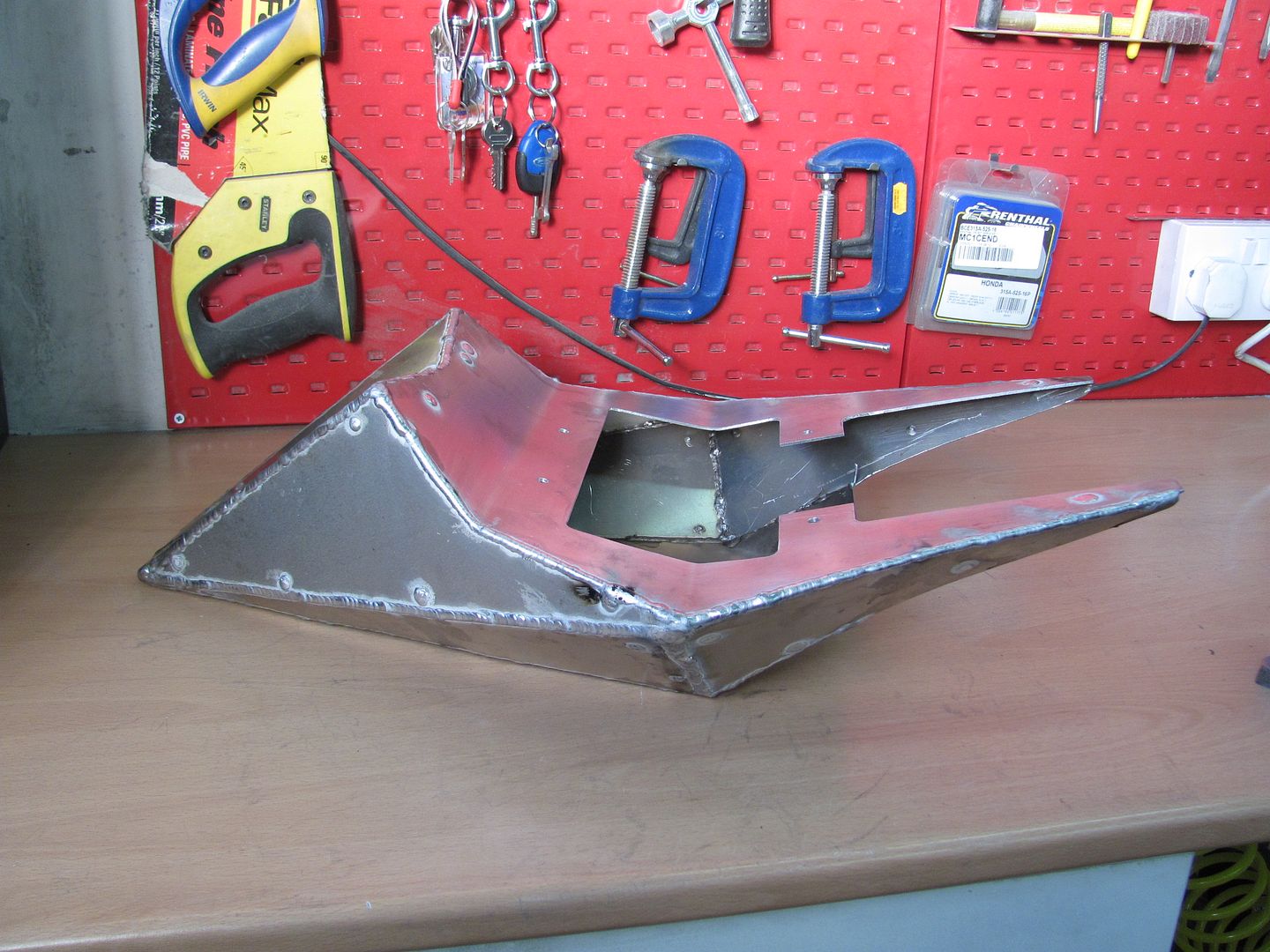

Got the tail welded up
And got the bottom half sanded, would liked to have got it all sanded but I can't use power tools after dark :(

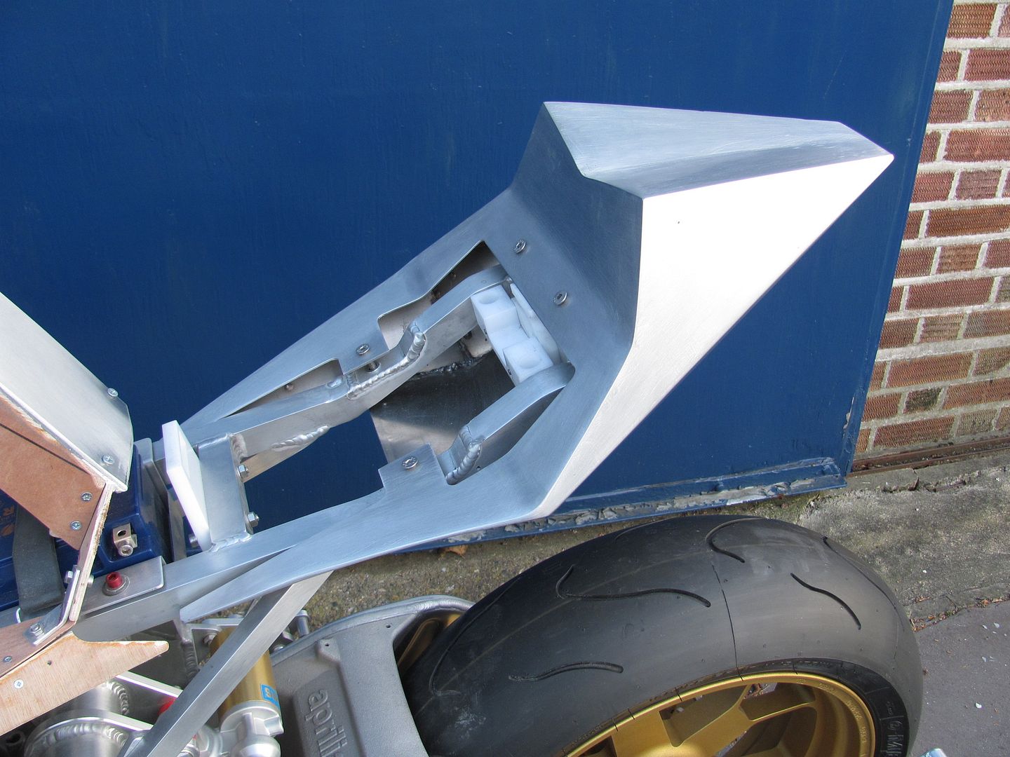

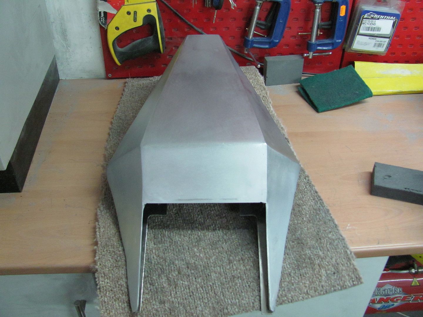

Got the tail sanded and finished, well pleased with it :)

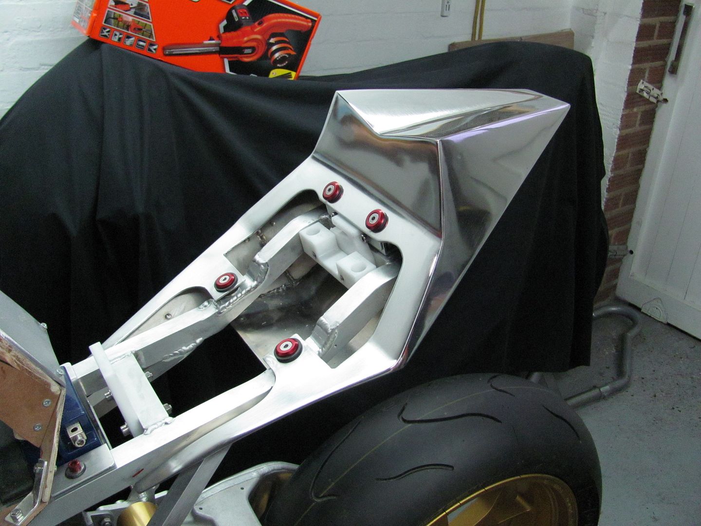

Tiny update:

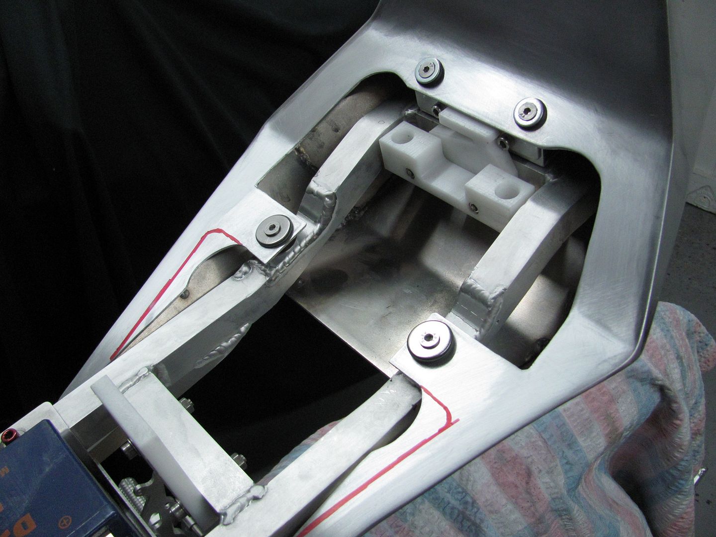

Got the rubber mounts for the tail made
Then rubbed down the tail to remove all the imperfections.
Bit of bad news I got a ASBO warning for noise (angle grinder use at 9pm) so progress might slow down a bit, my local welder said I could use his workshop in business hours so a little help.

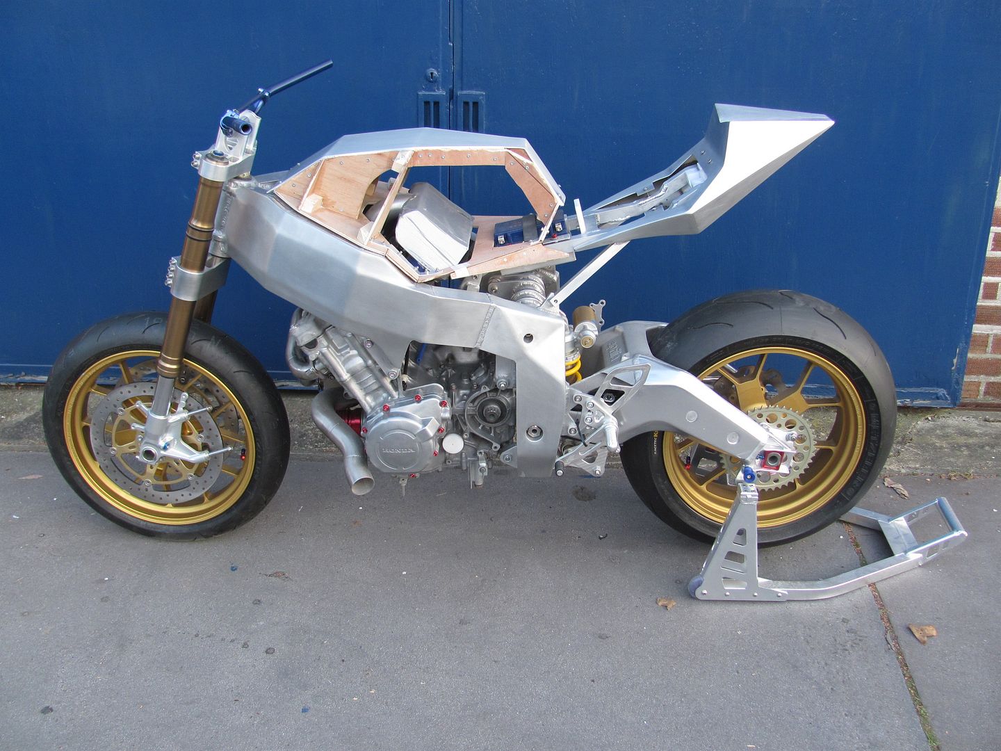

Little update
Fitted some nice anodised countersunk washers for the tail mounts, yes I know they can't be seen with the seat on but I know they are there :D
Started fitting the tank side sections, will have the tank top half finished tomorrow night
And deciding if the bike should be painted or polished?
