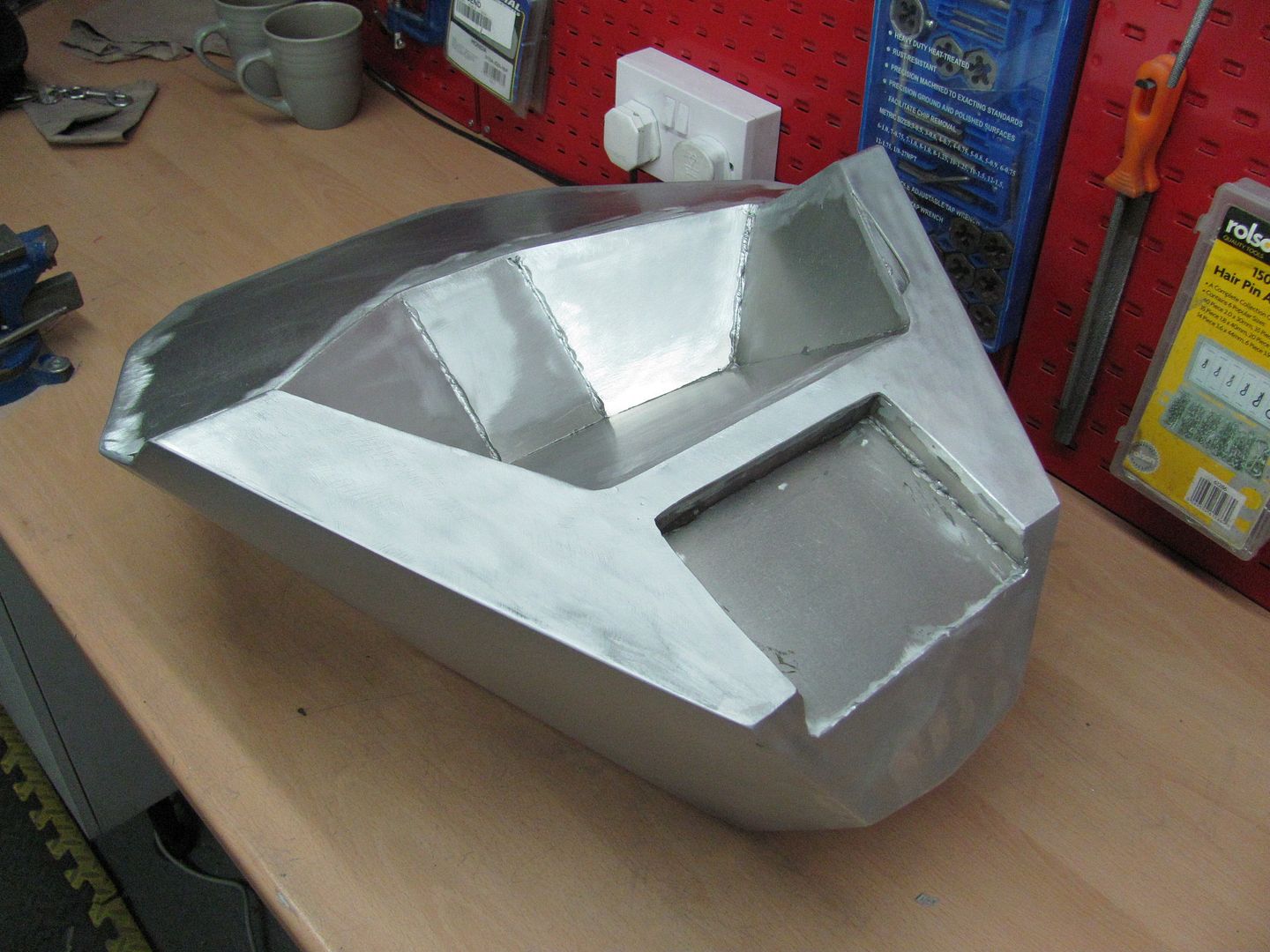

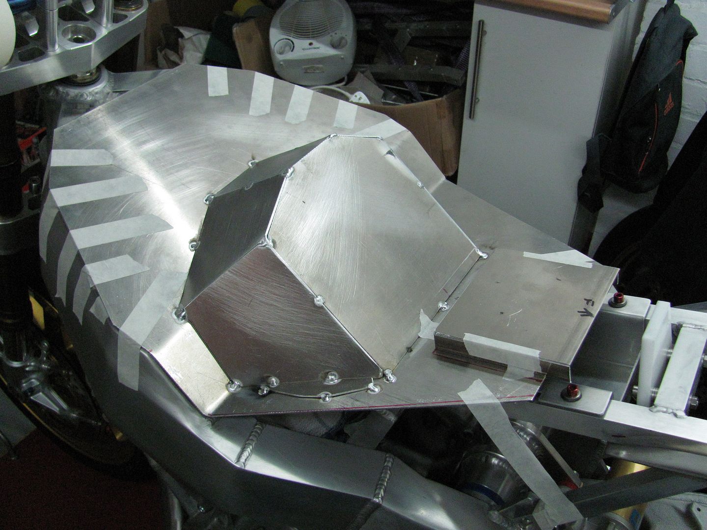

Got the tank base finished with air box and battery cut out's ready for welding

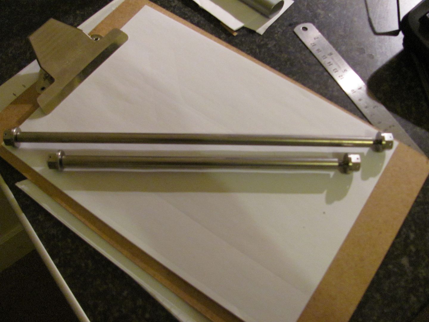

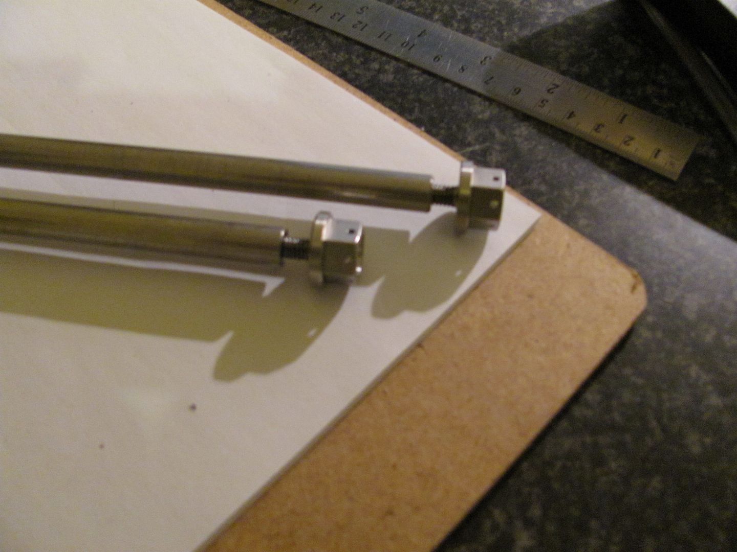

Check out the new engine bolts I had made by streetfighterbling.net

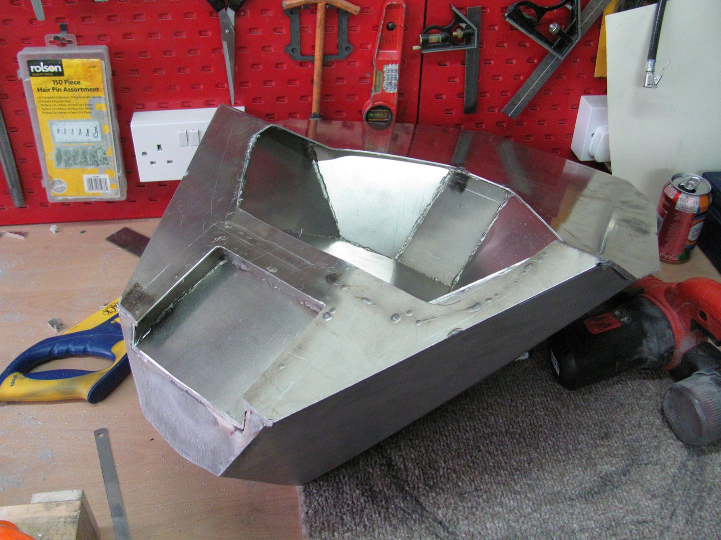

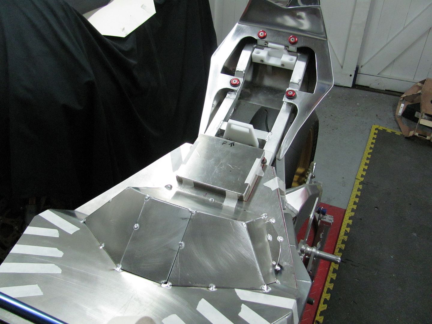

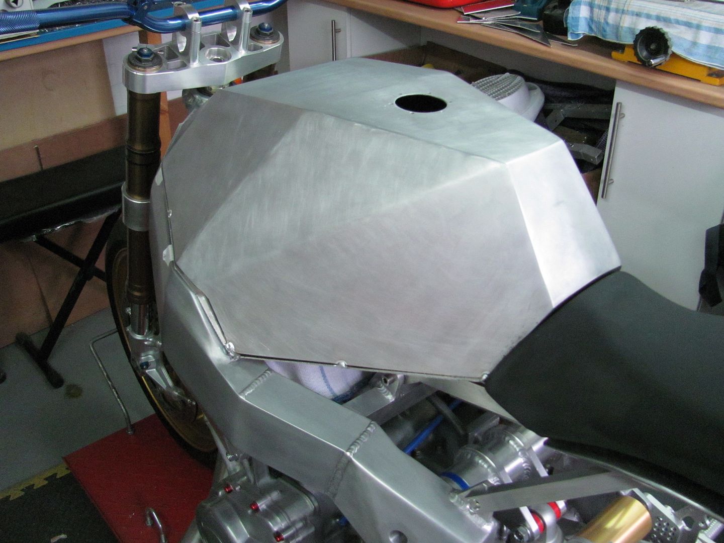

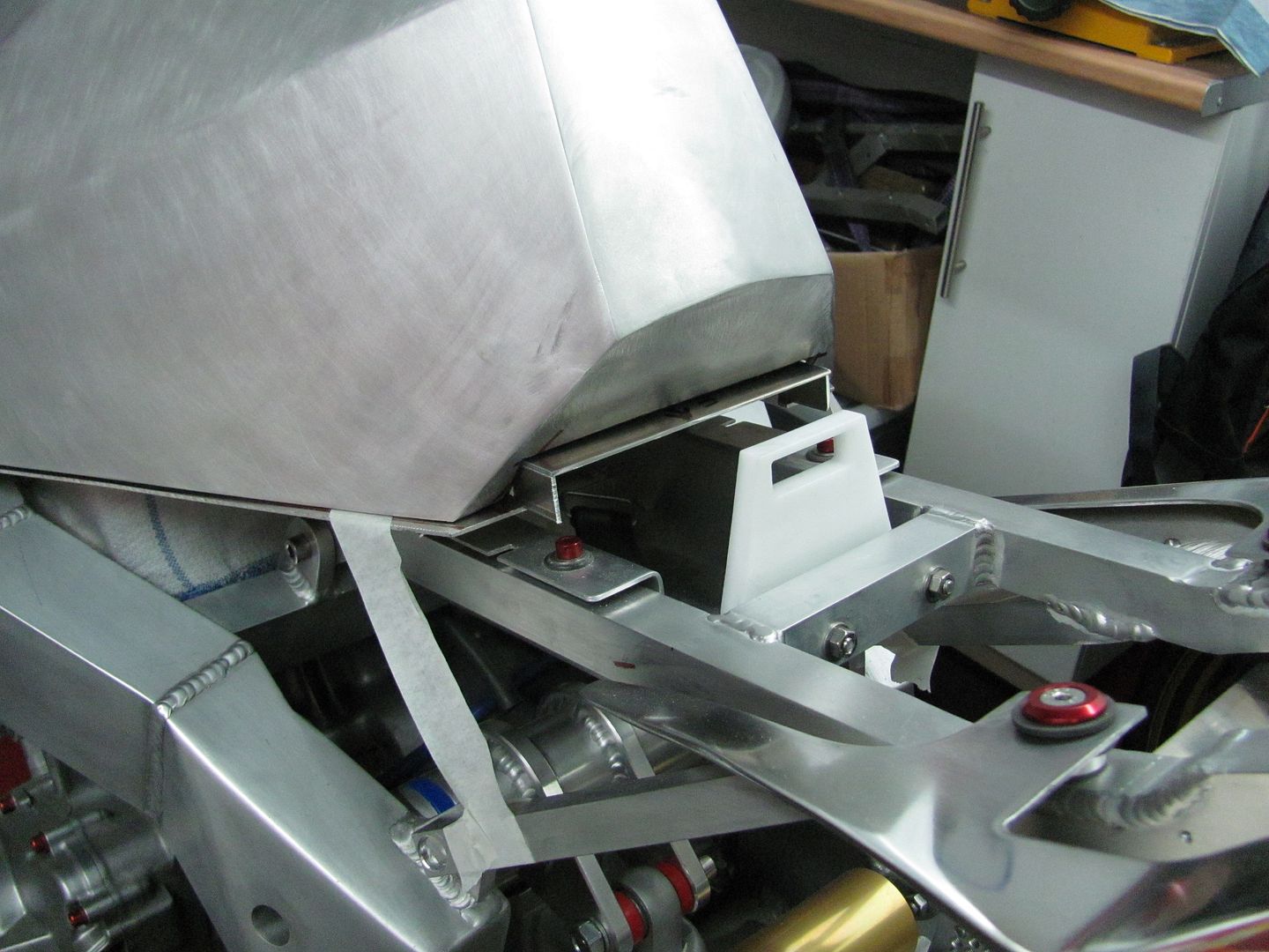

This might not look like much done here but I was really worrying over the last few weeks about finishing the tank, I knew getting all the internal welding done would warp the ally sheet of the bottom section, but getting one join welded then letting the piece cool down has worked, got all the internal welding done (just need to grind all the edges)
And the top half tacked in place, tank fits perfect, will mack up the rear mounts tomorrow.

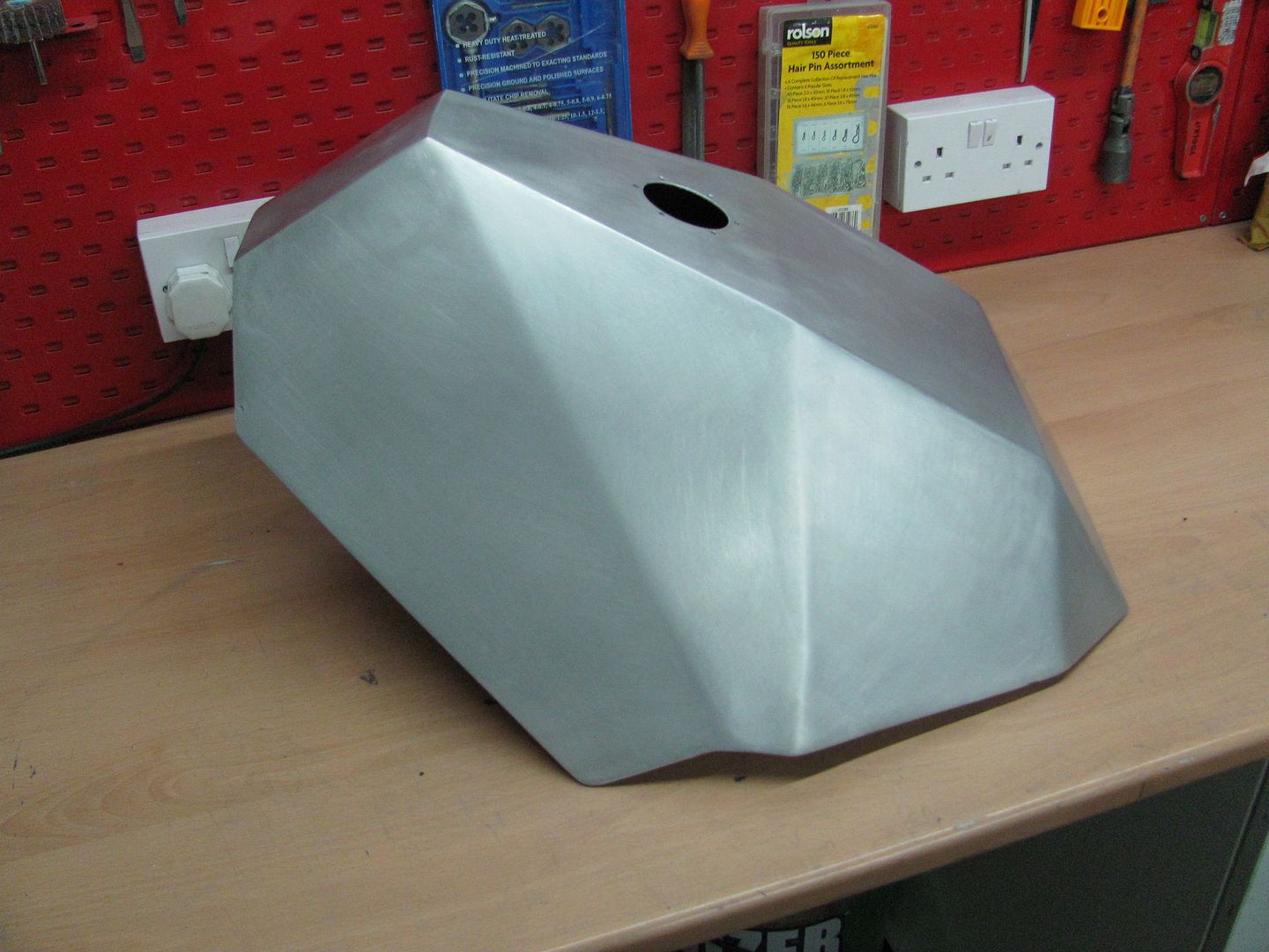

So here's the finished tank, welded together and sanded down, fits the bike superb too!!! nice.
MessagePublié: 05 Avr 2012, 22:09
Ça paraît si simple :amen:

nice bro!!
did you tested the tank to see if its not leaking? ;)
