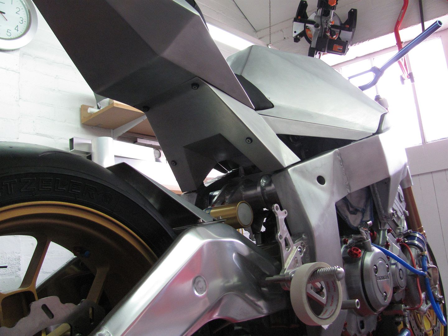

This side panel for the subframe cover took me two afternoons and 3 attempts to get right! just need to do the other side now :(
Once all the bodywork is finished there will only be two 5mm screws showing in the back panel of the subframe cover so from the side no fixing will be visible wich will look nice :)

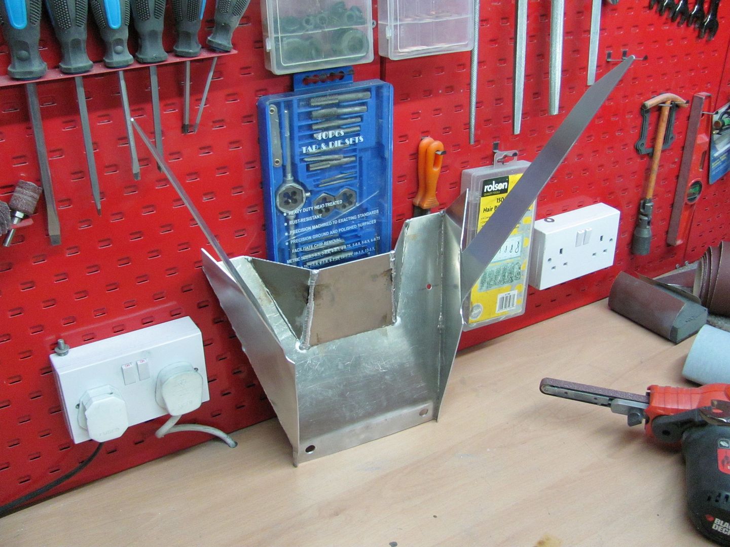

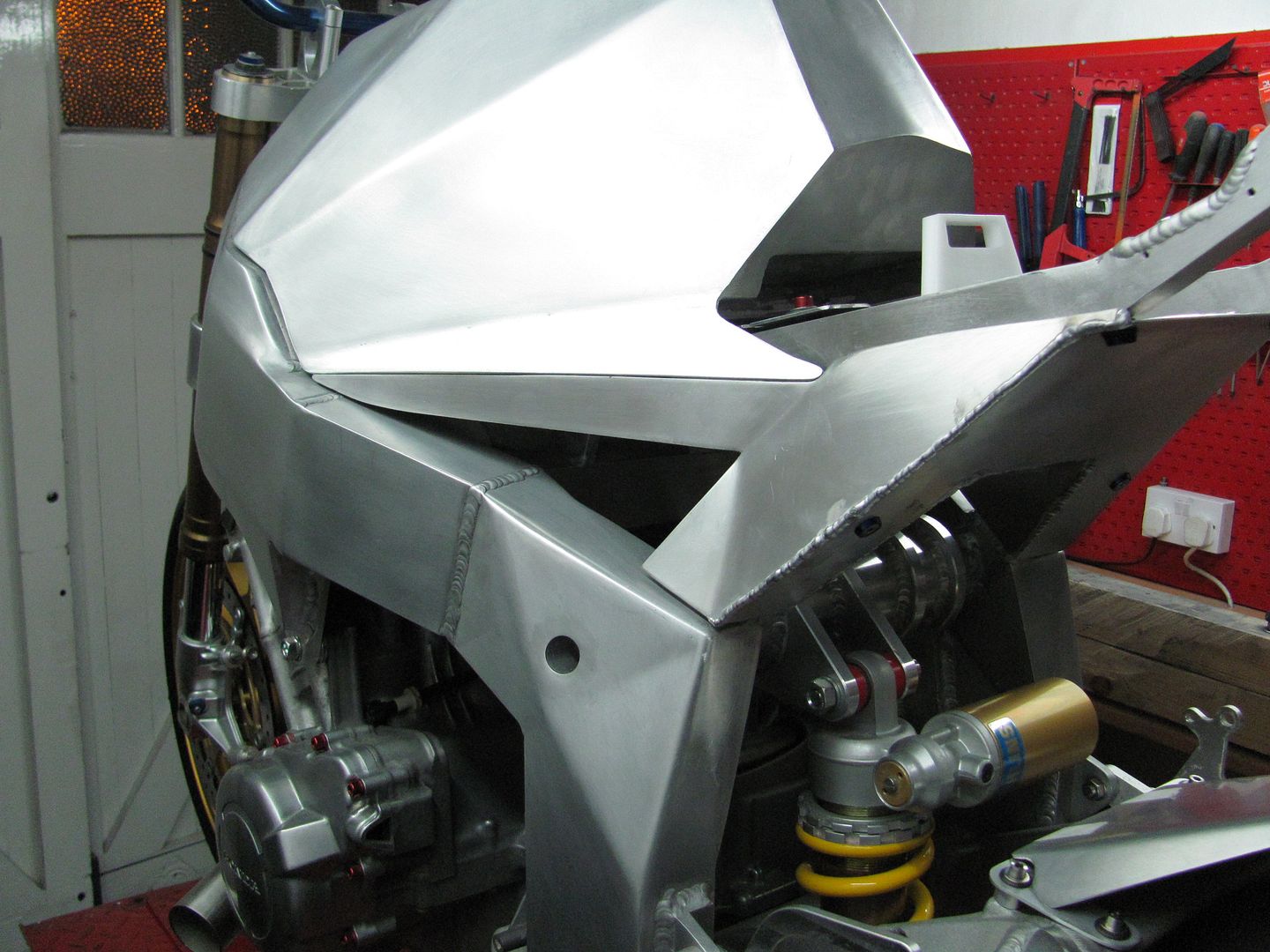

Well this was a lot harder than I thought and took a week of afternoons but it's done.
Welded up
And it fits kin perfect! I left a small gap to the frame so it will look like it not connected (bit different lol) started rubbing the seams down but got too late, will finish it tomorrow.

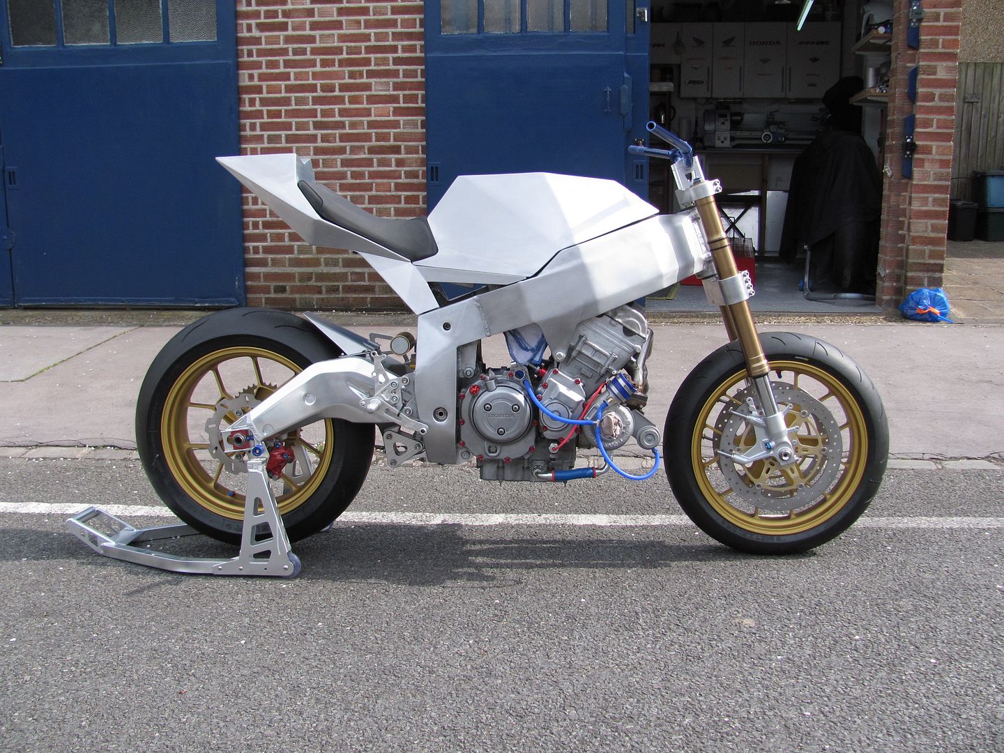

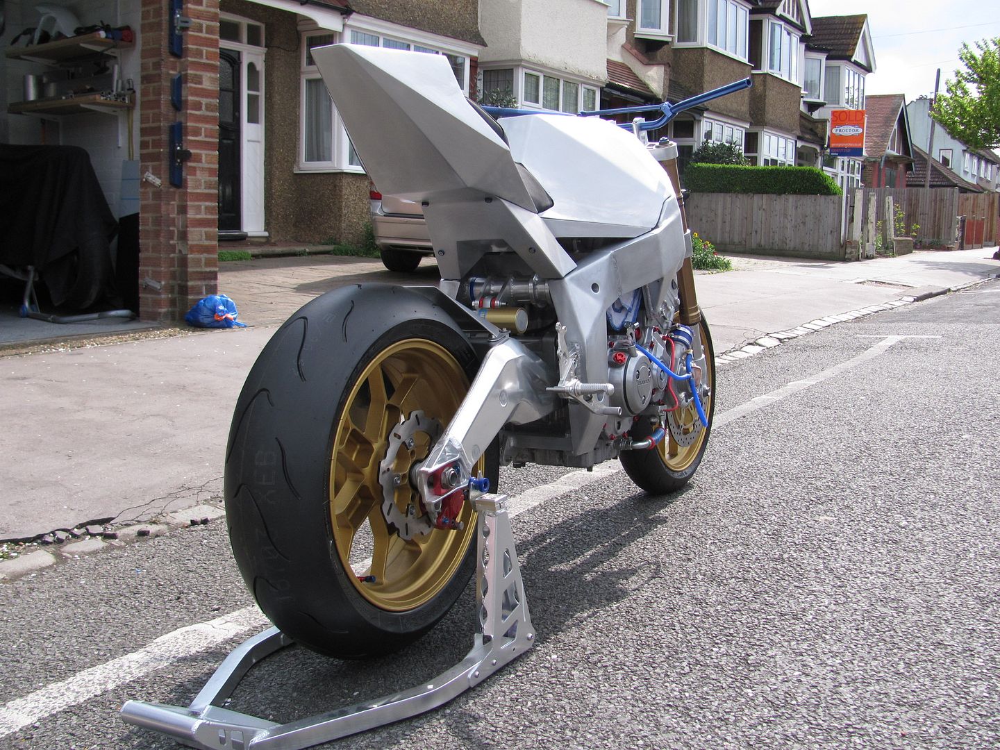

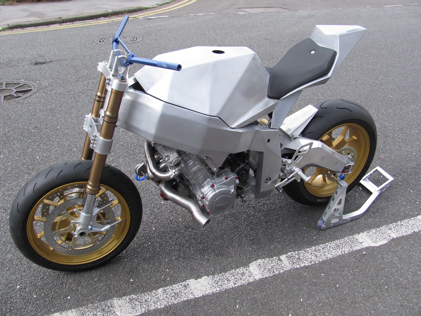

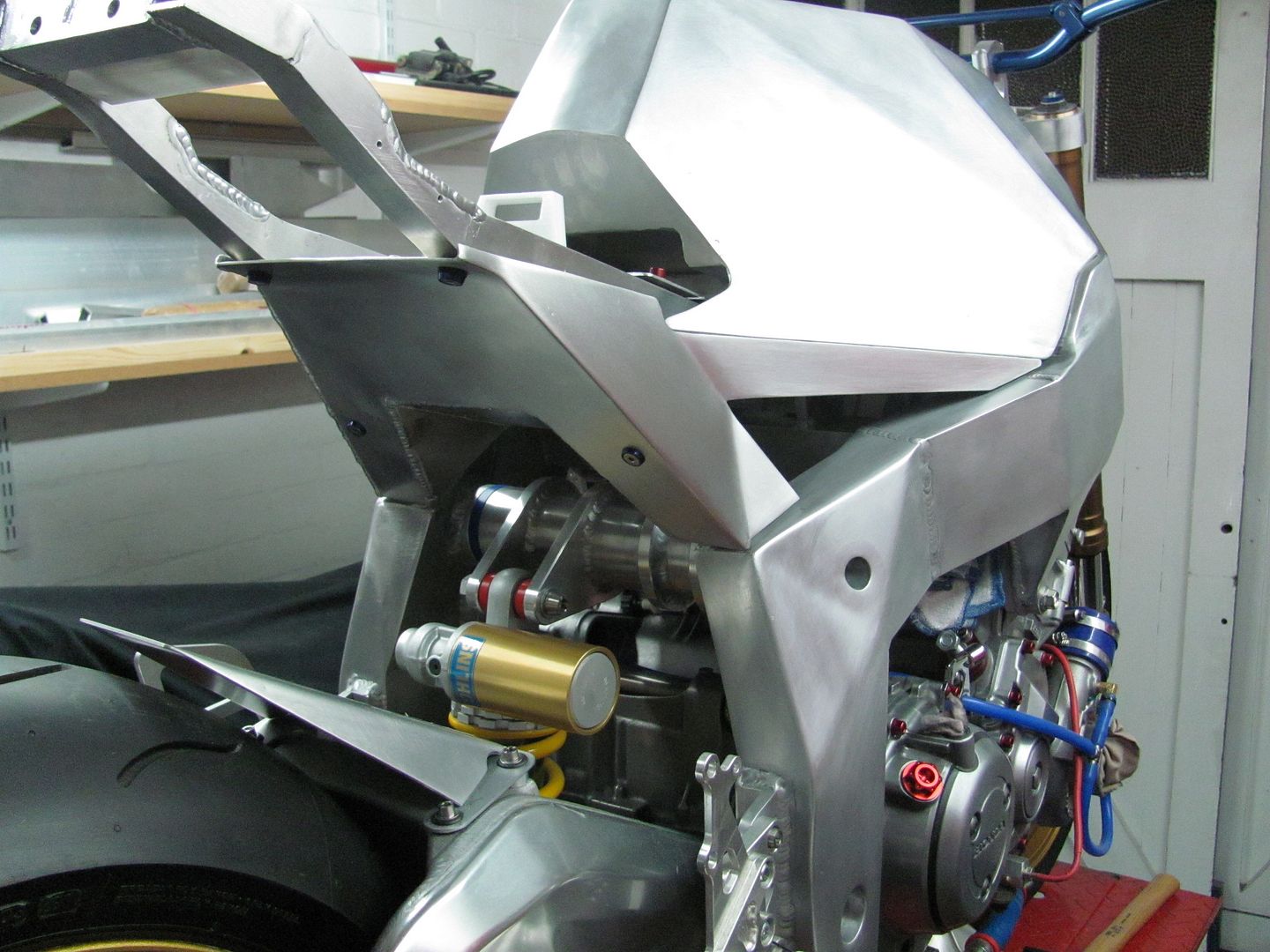

Another day sanding!
Cover finished
An hour to get cover to tail fit good

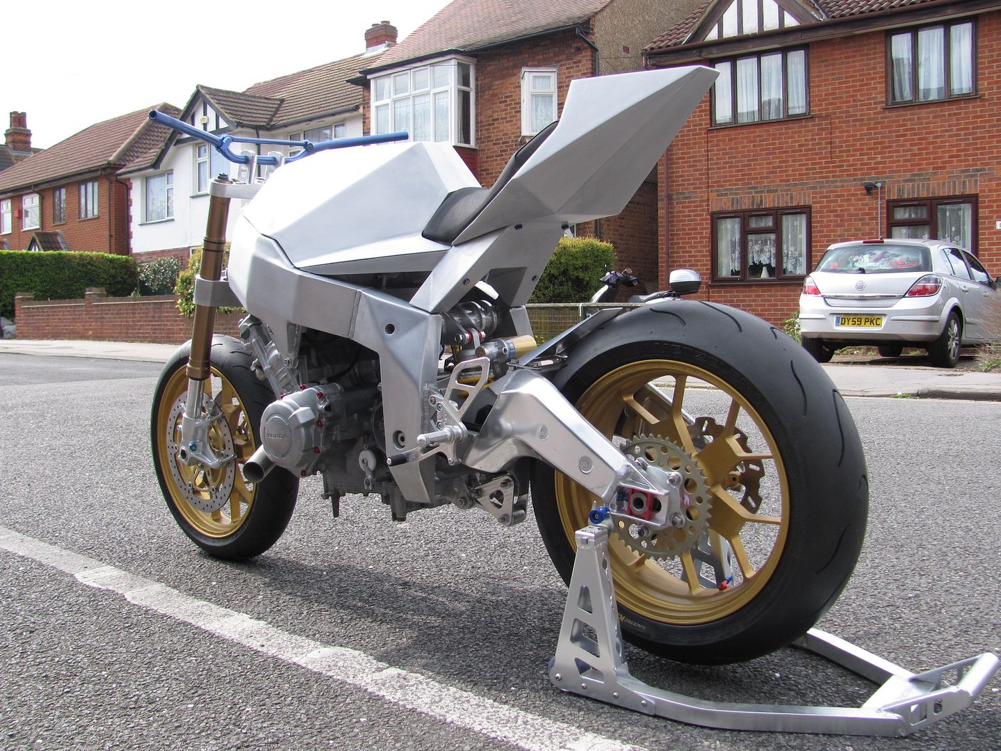

And as the sun was shining a few outside pix :D
Will start the front mudguard tomorrow

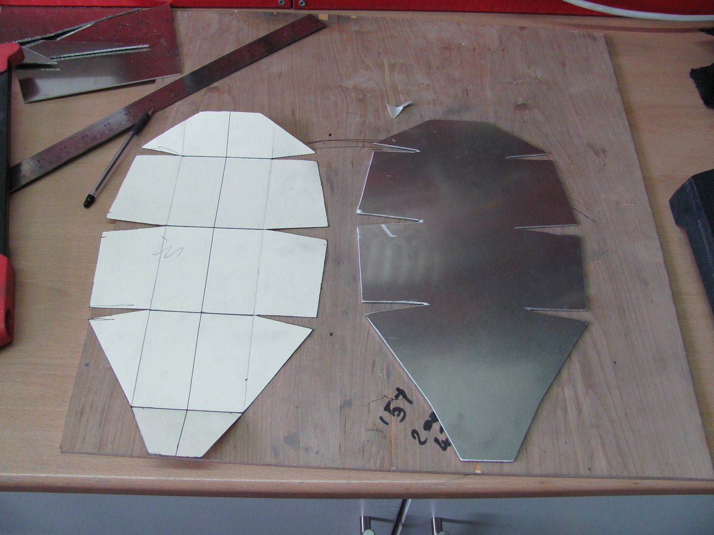

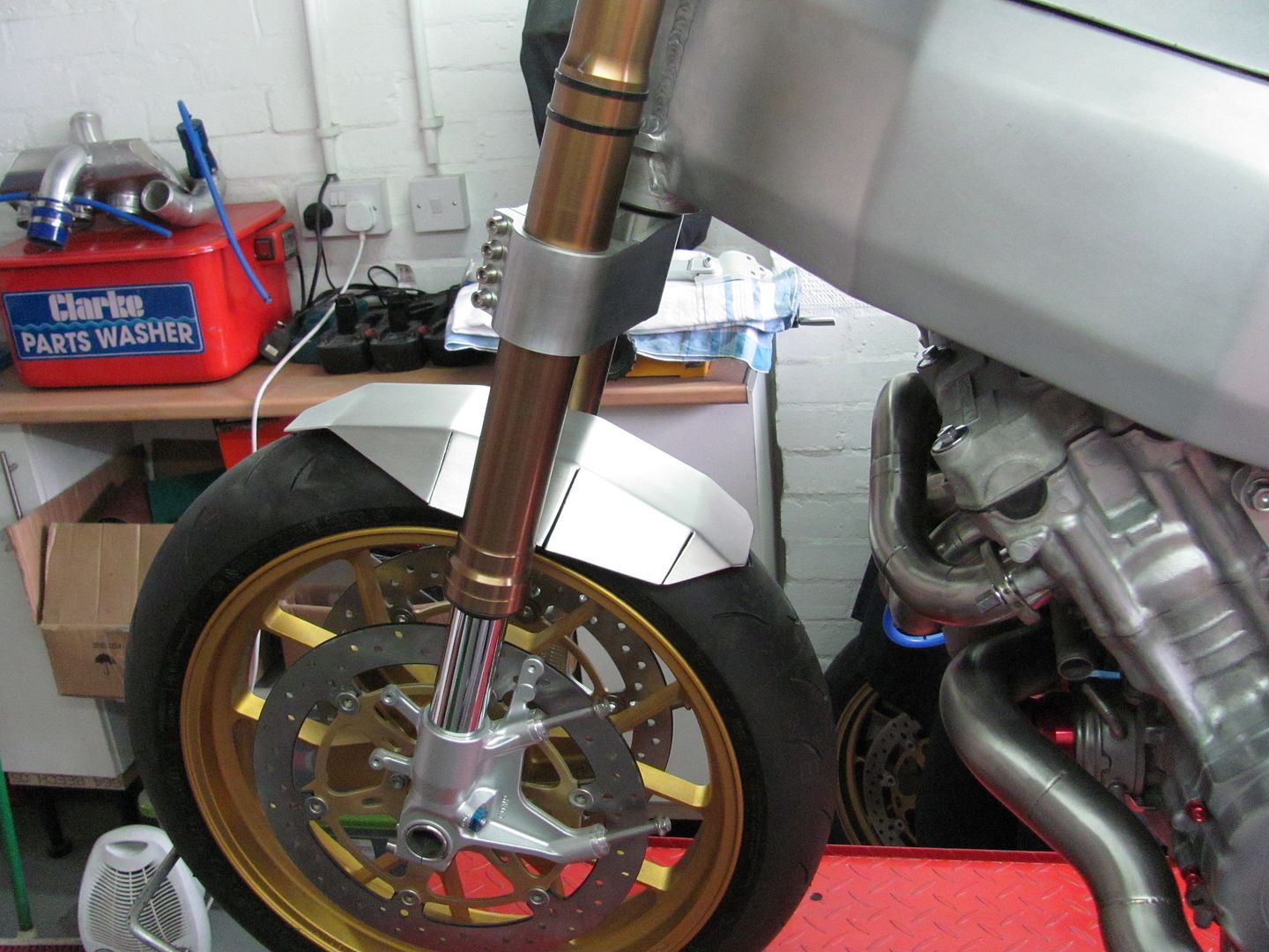

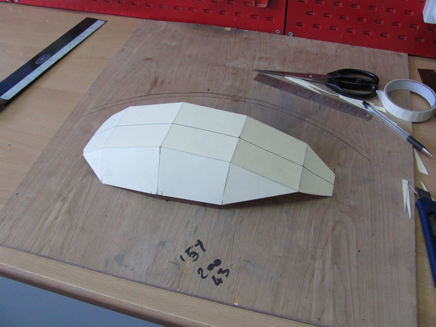

Made a start on the front mudguard.
Paper pattern (6th one lol)
Cut out ready to fold
Folded, I'll use 4 cable ties round the forks to mount it, should be ok.
