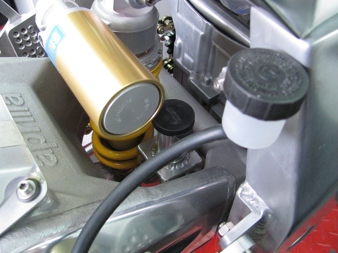

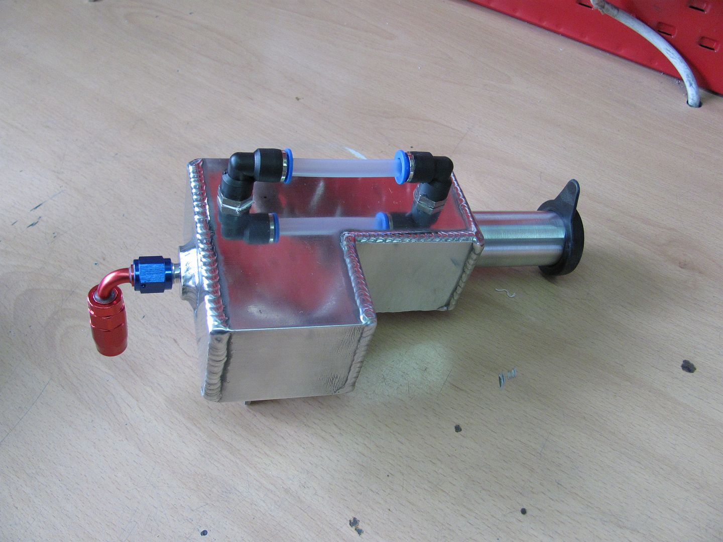

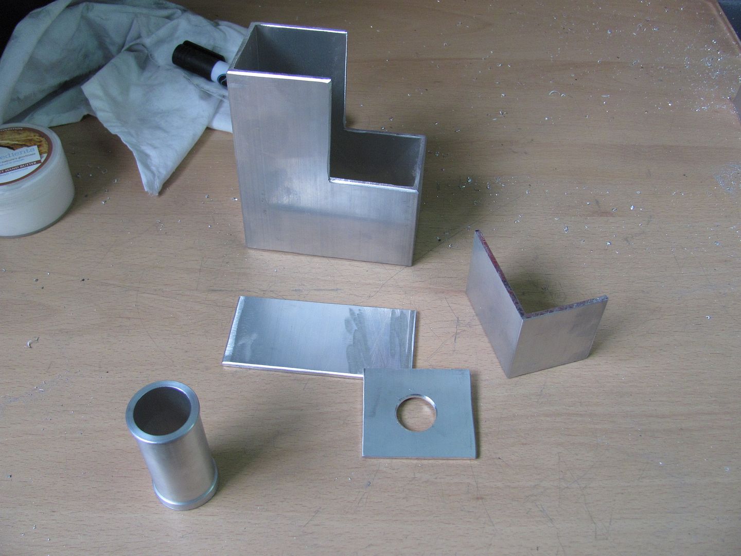

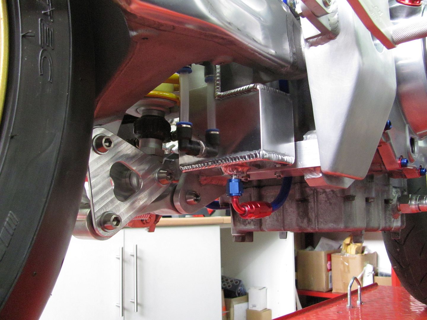

Forgot about the expansion tank!
Cut up some box section
Weleded up and fittings added
On bike

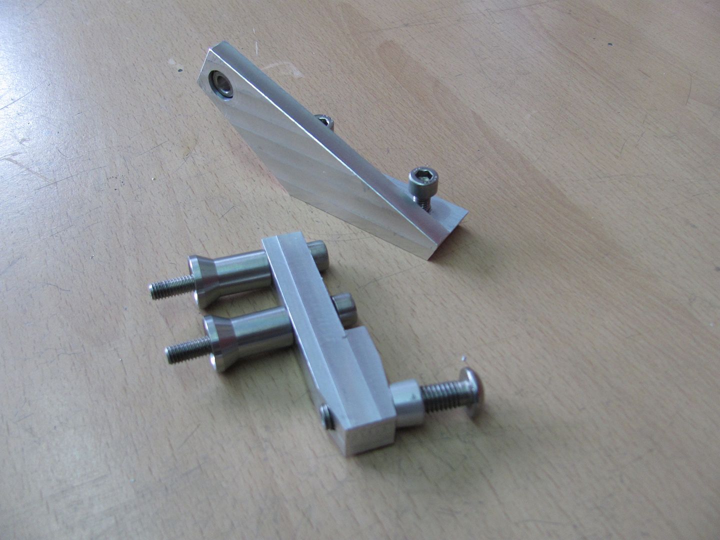

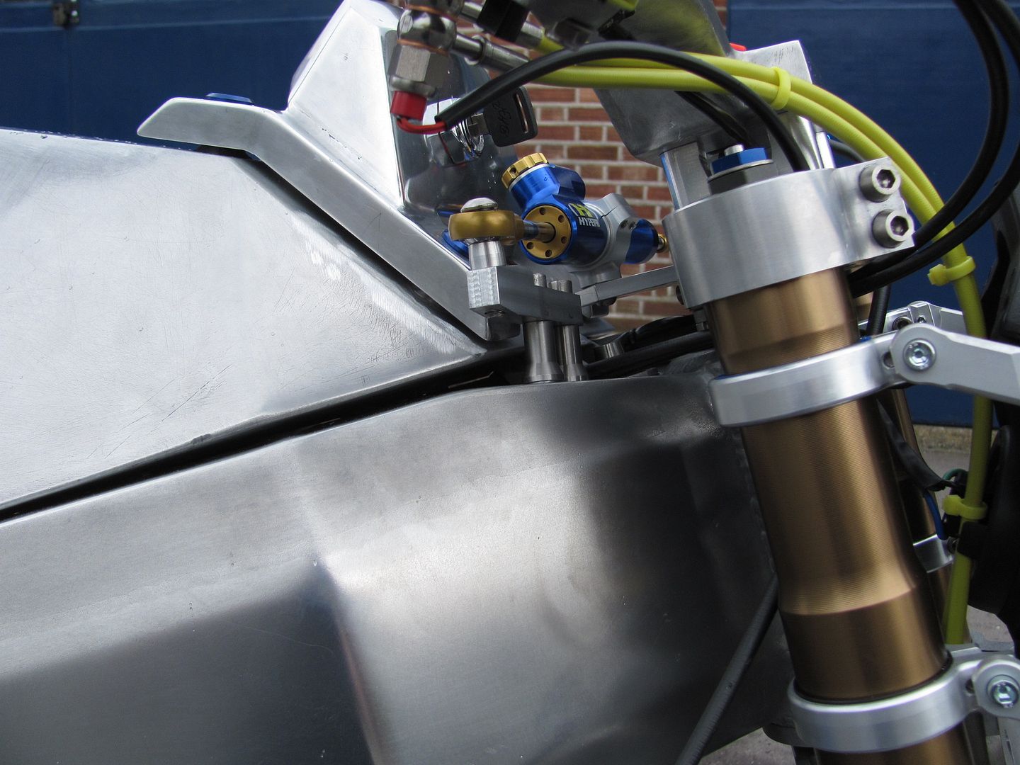

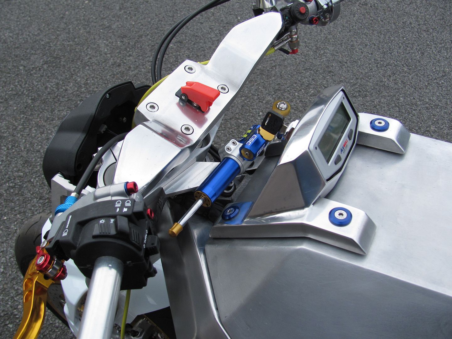

Made some steering damper brackets
And damper fitted
New headlight
Little show plate :)
So the next up date will be the bike finished with paint etc.
