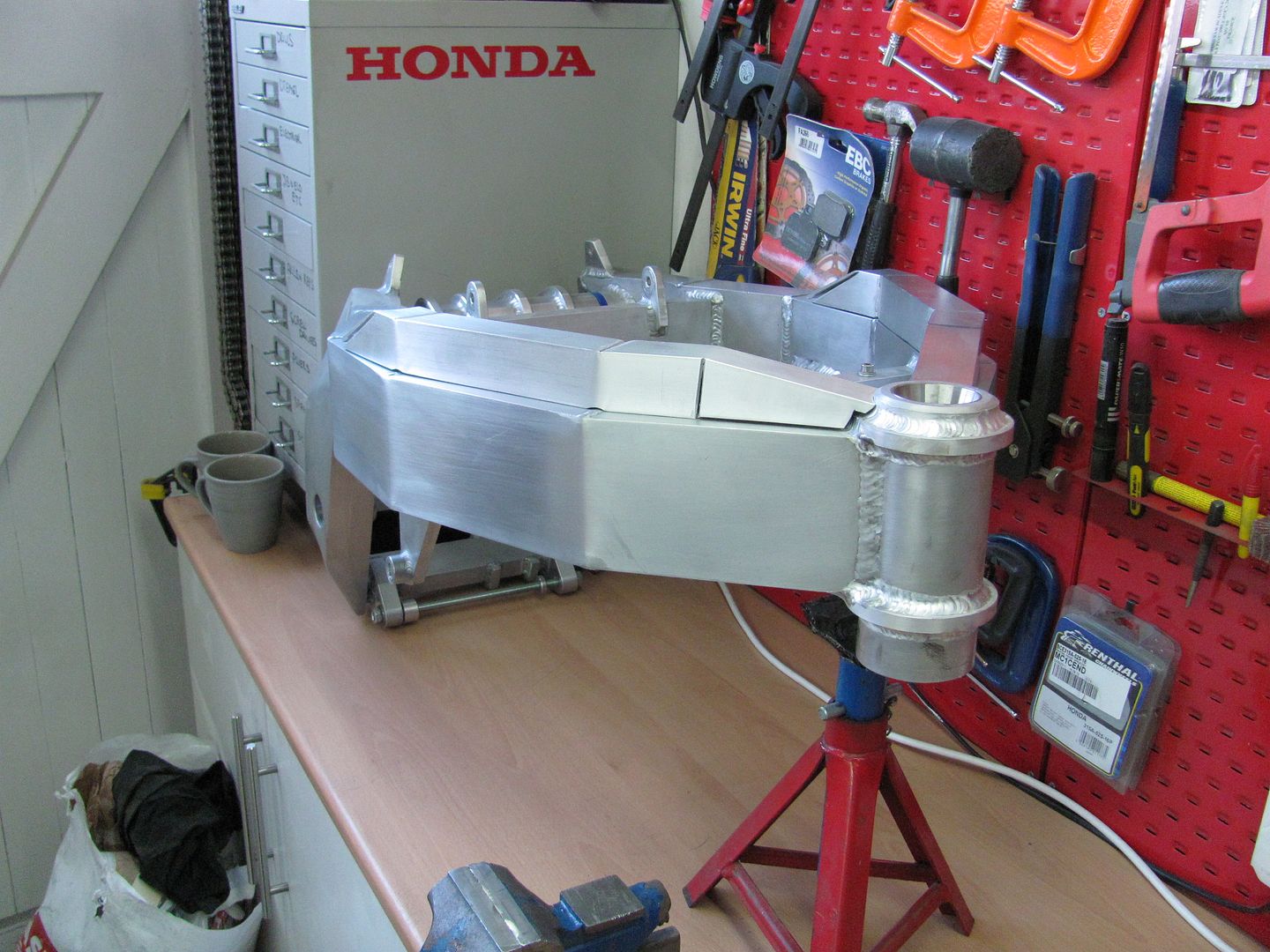

where is the pic off the subframe?? :lol: :lol: :lol:

:siffle: Picture added :siffle:

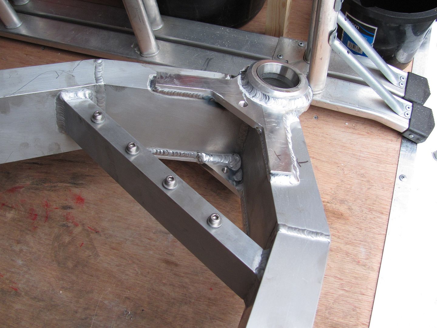

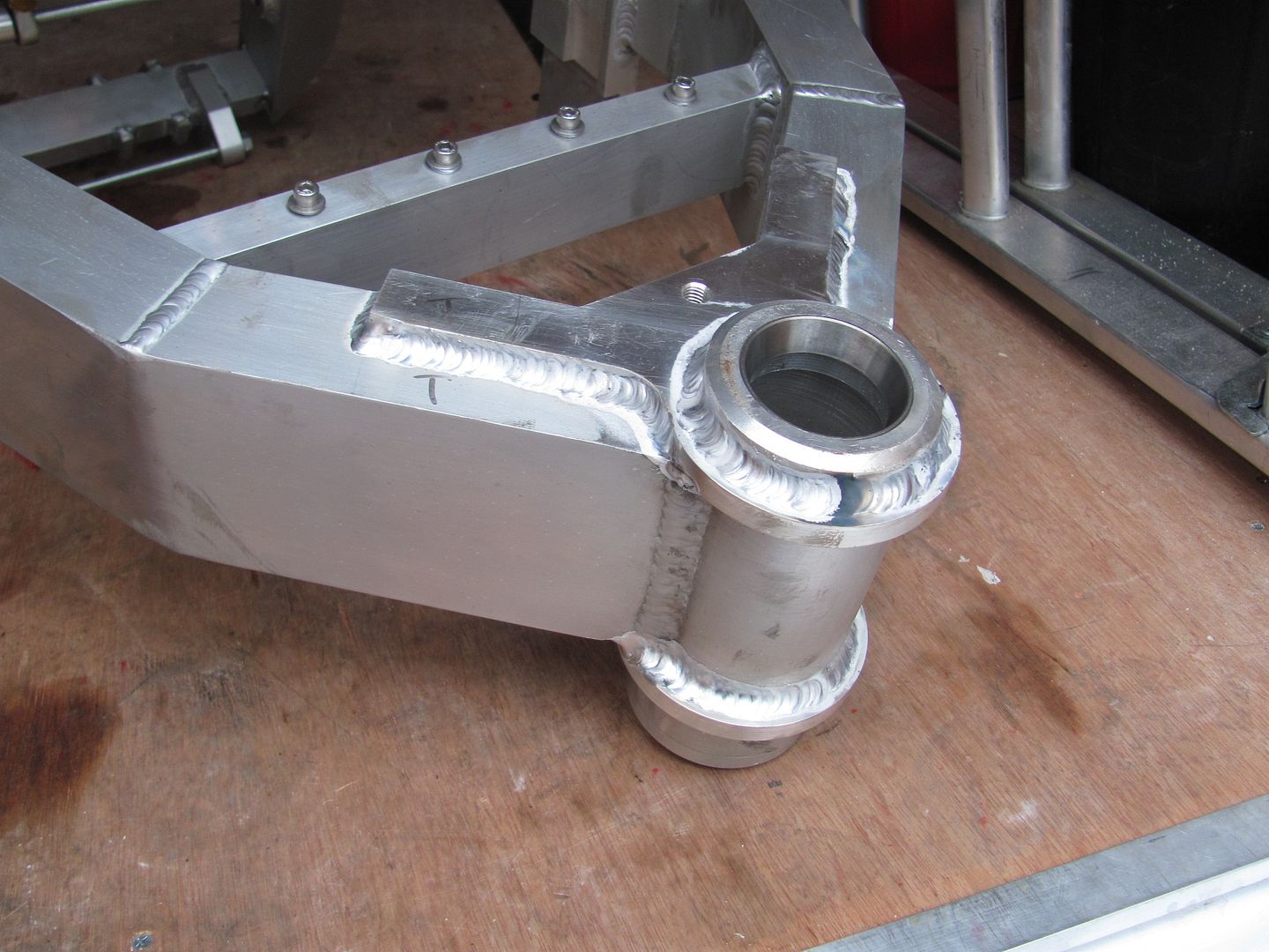

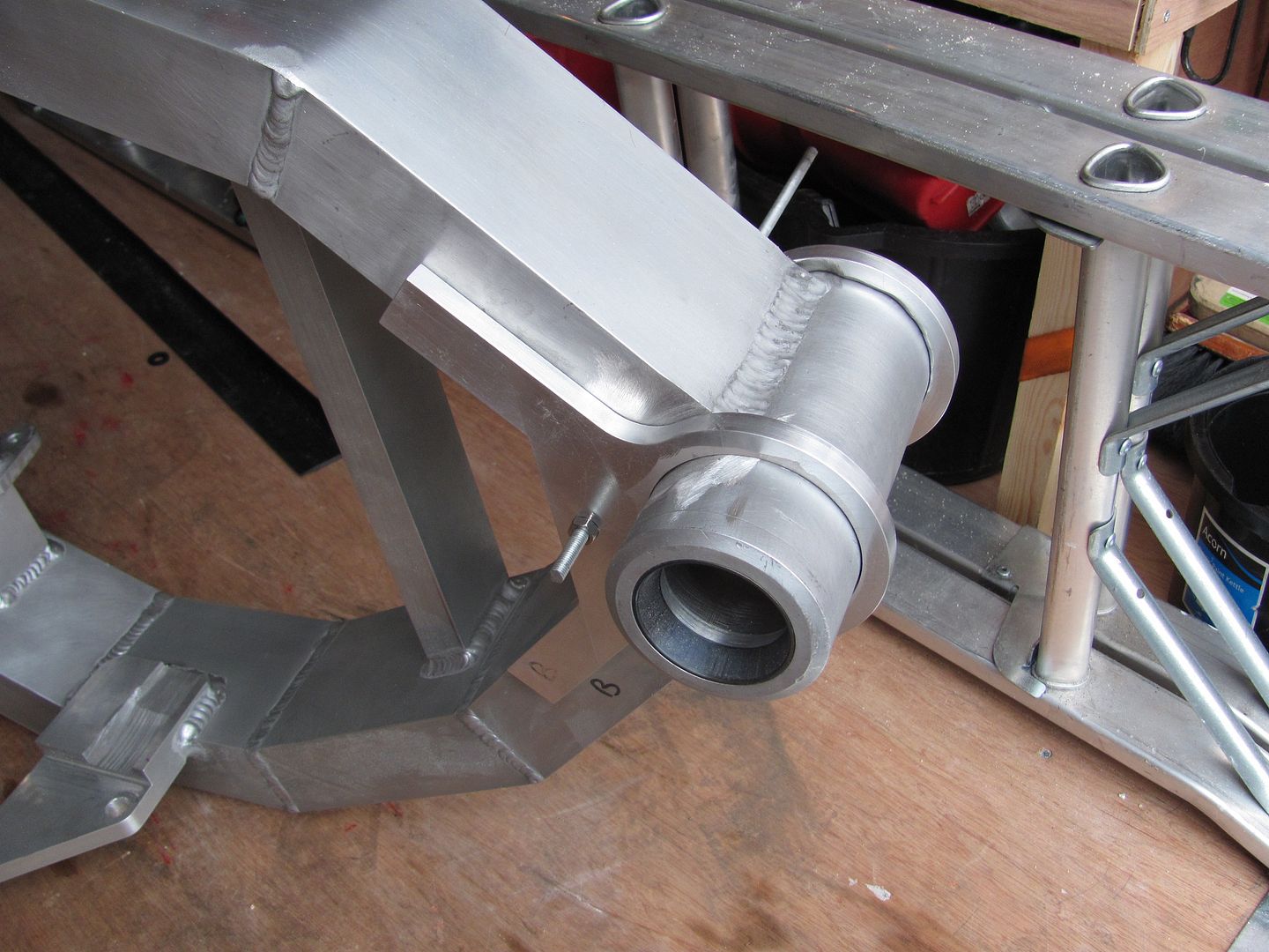

Headstock braces

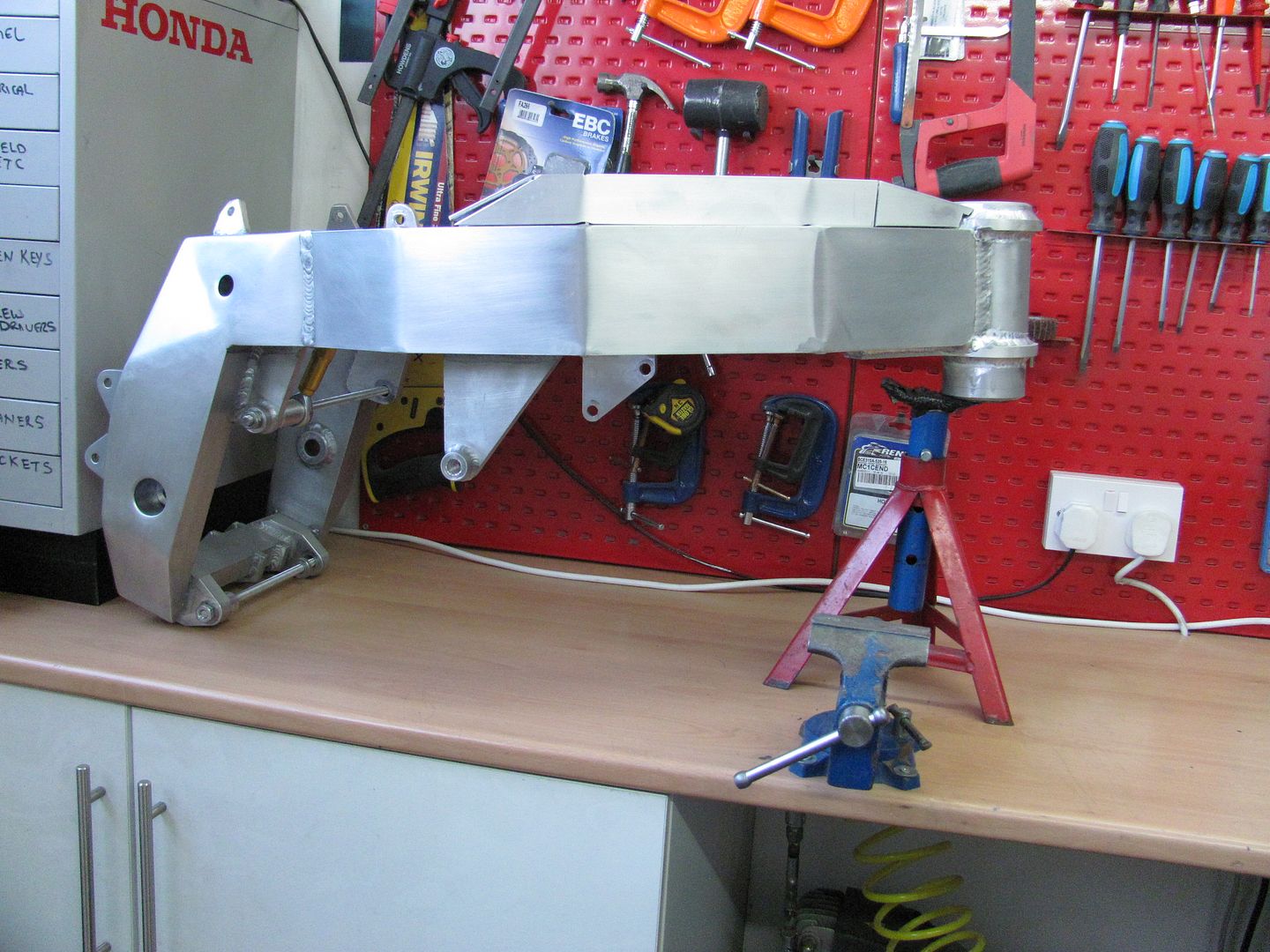

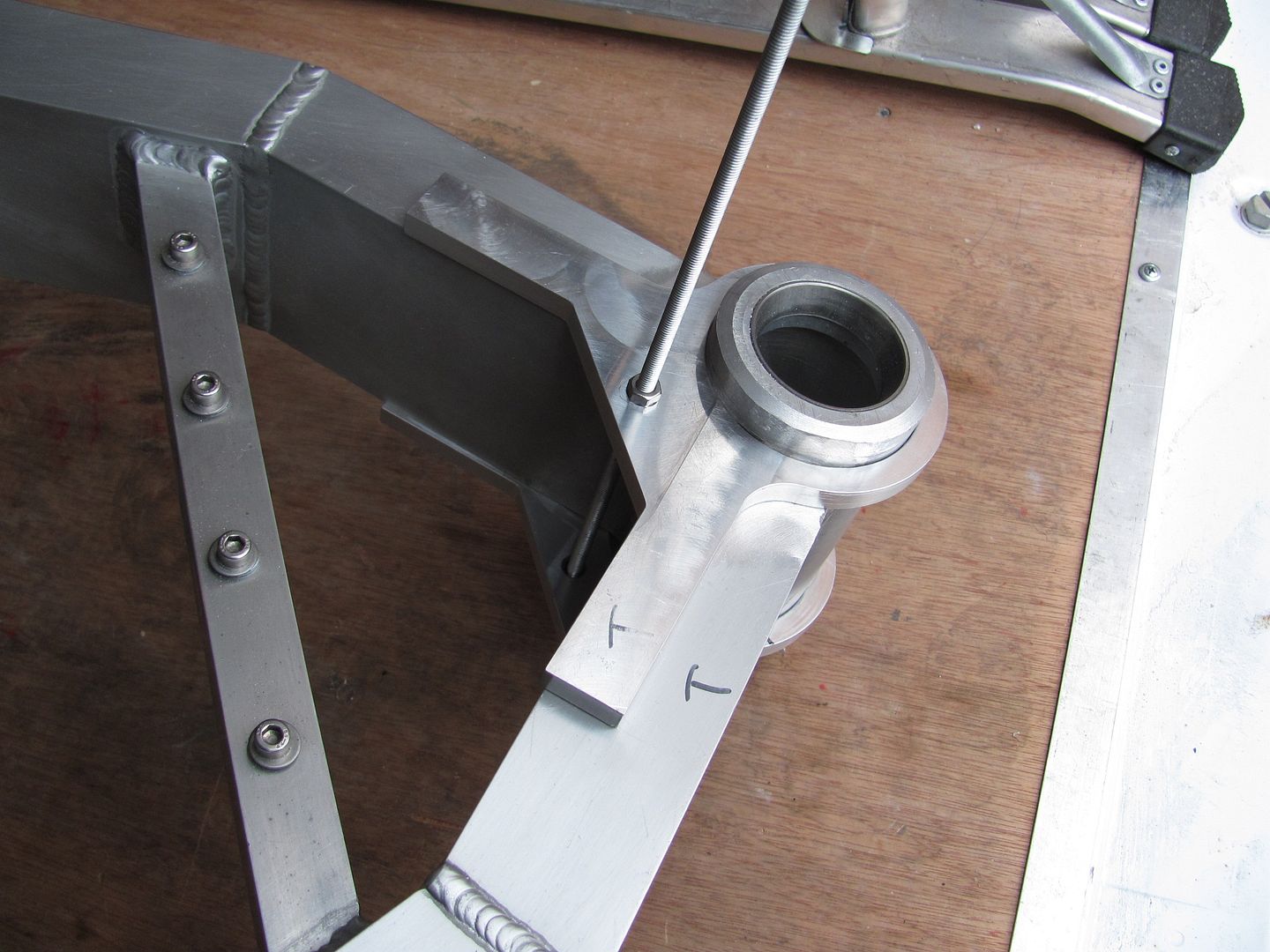

Got the top sections cut and ready for welding Monday, I would have made the bottom sections too but I didn't have any more material, once the top and bottom sections are in place covers will be welded across the "steps" and then smoothed down, this will give the finished look like a hexagon design.
