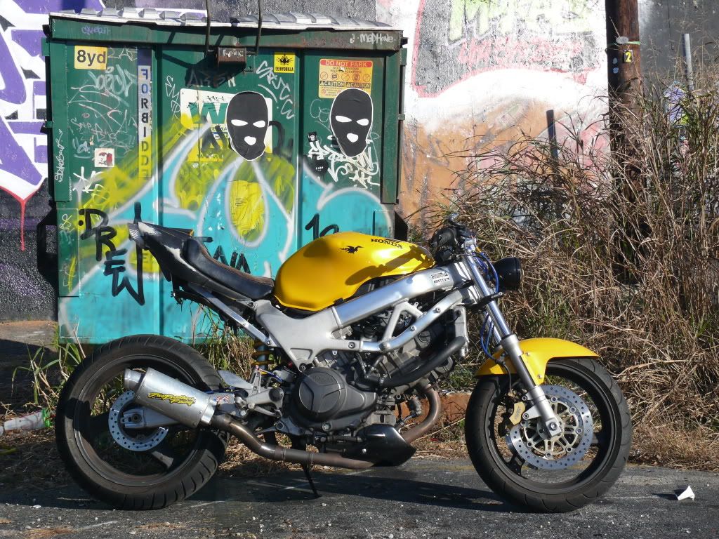

Some of you had asked to see some of my previous bikes. Here are a few that have been done over the years.

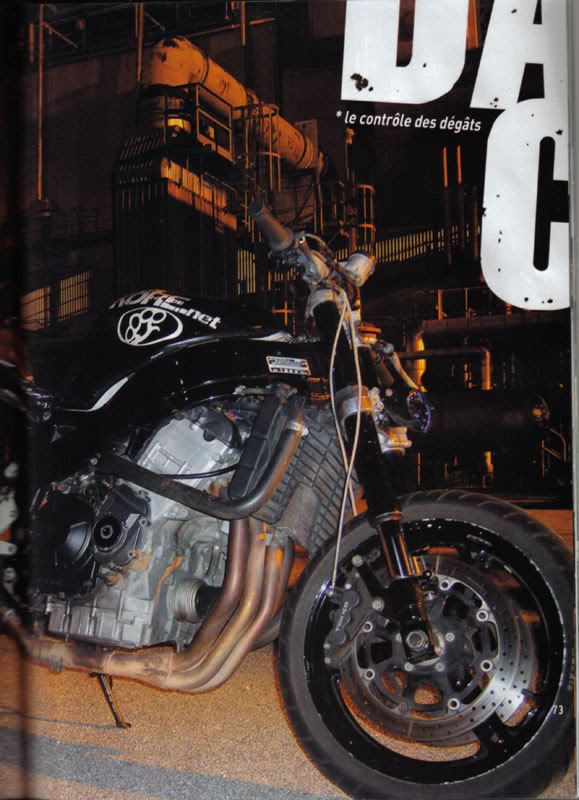

Damage Control CBR900RR.
Featured in Extreme Machines #4

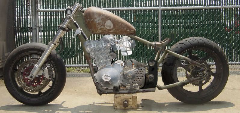

VTR1000F, unfinished project.

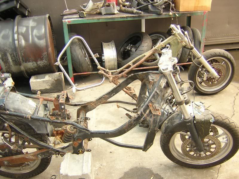

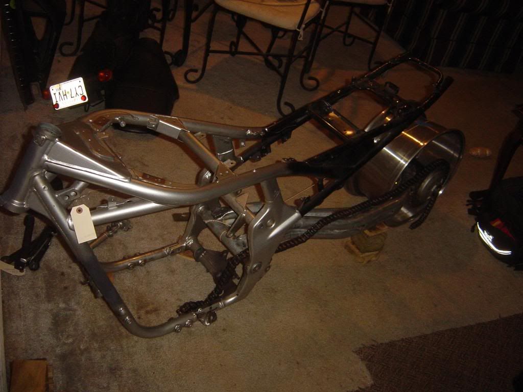

Current project for a friend. 2003 Suzuki B12. We are building the bike over from scratch now. I did the ZX10 tail conversion.
Also making custom adjutable clip-on Z bars.

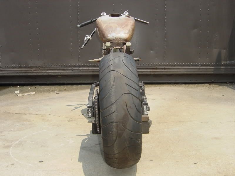

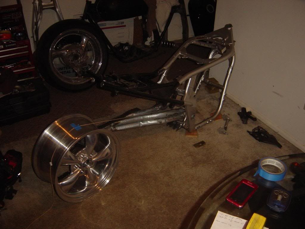

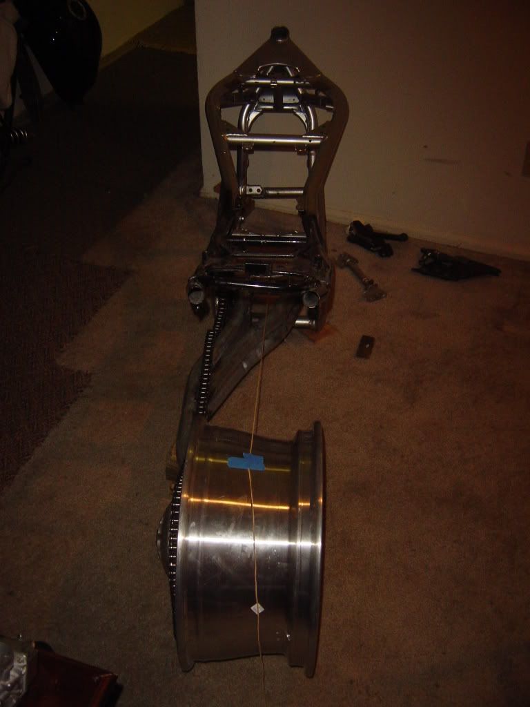

As it sits today. We are building a custom monobra with 18x9 Mustang wheel and 250 tire. +9 inches long.
As well as many other custom parts.

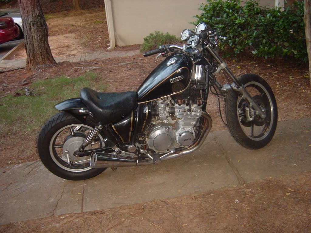

Current small project. Yamaha XJ700 lowrider.
Another unfinished project. Suzuki LS650, GSX600F engine, CBR900RR suspension
Some ideas for projects in the works

We are using the spindle from an NT650 that we pressed wheel studs into. We will be using a wheel adapter to go from 4x100 to 5x114. The hard part so far is finding that sytle wheel in the correct offset to keep it centered. our local wheel shop has been very helpful and letting use items in stock to make sure our math is correct ;)
